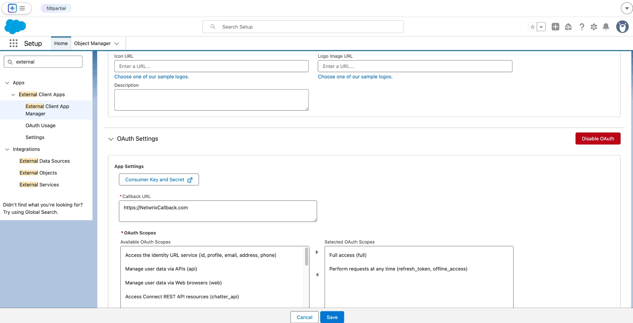

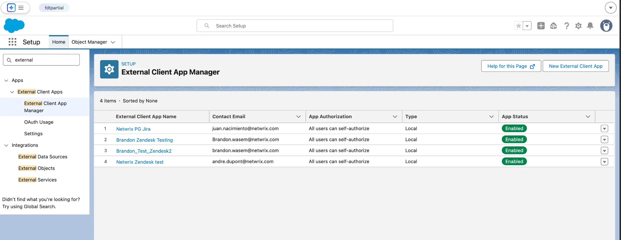

Configure the External Client Apps (new version of connected apps):
  1. Log in to your Salesforce org.
  2. Open the Connected App: Setup > Apps > External Client Apps > Netwrix Pg Jira (Netwrix Pg Jira is an example; it doesn't need to have that exact name.)
    Open the Strongpoint Connected App
  3. Click the dropdown arrow on the right side and select Edit Settings.
  4. Set the Callback URL to https://spjira.my.salesforce-sites.com/SpHandleJiraAuth under the Oauth Settings Section
  5. These Oauth Scopes must be selected: Full access (full) Perform requests at any time (refresh_token, offline_access)
  6. Click Save.
    Your connected app requires 2-10 minutes after you save before it is available.
  7. Click Consumer Key and Secret.
    Click Manage Consumer Details
  8. Copy the Consumer Key and the Consumer Secret codes to a clipboard. You are prompted for this information when you use the app.
