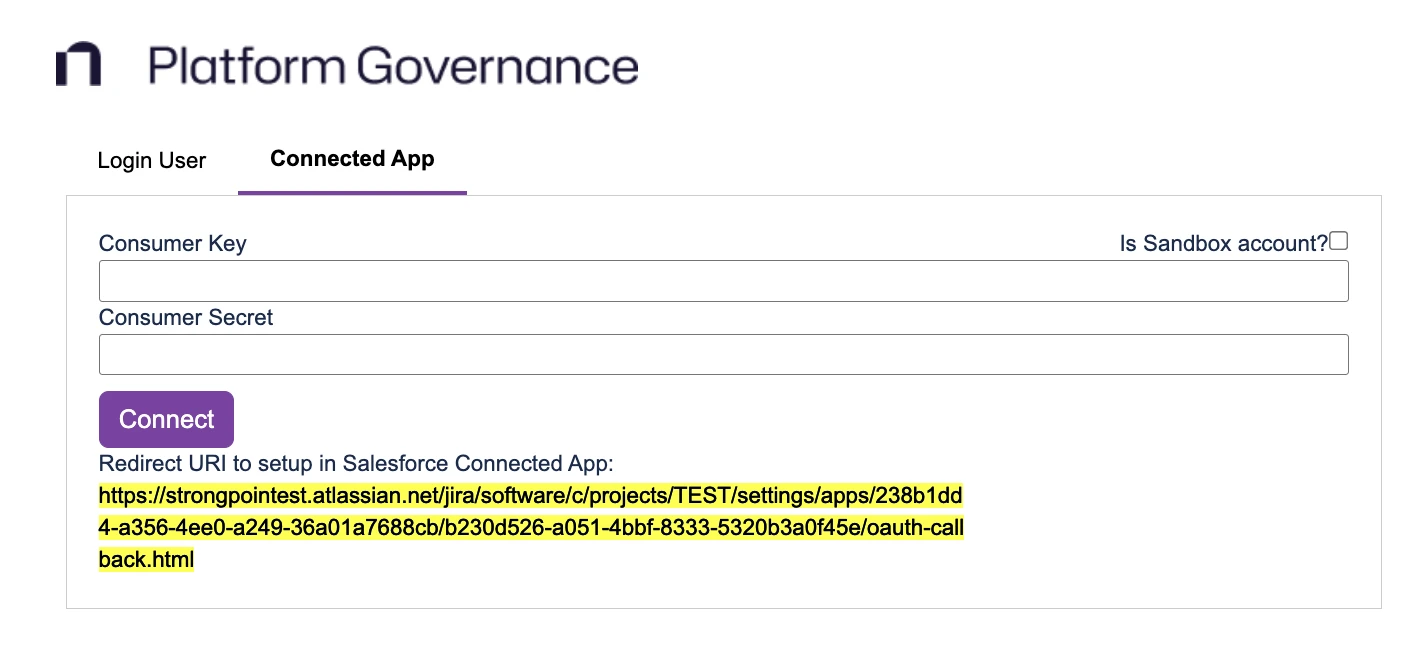

  4. Set the Callback URL to see in the forge integration Link oauth callback forge
  5. These Oauth Scopes must be selected: Full access (full) Perform requests at any time (refresh_token, offline_access)
  6. Click Save.
    Your connected app requires 2-10 minutes after you save before it is available.
  7. Click Manage Consumer Details.
  8. Copy the Consumer Key and the Consumer Secret codes to a clipboard. You are prompted for this information when you use the app.

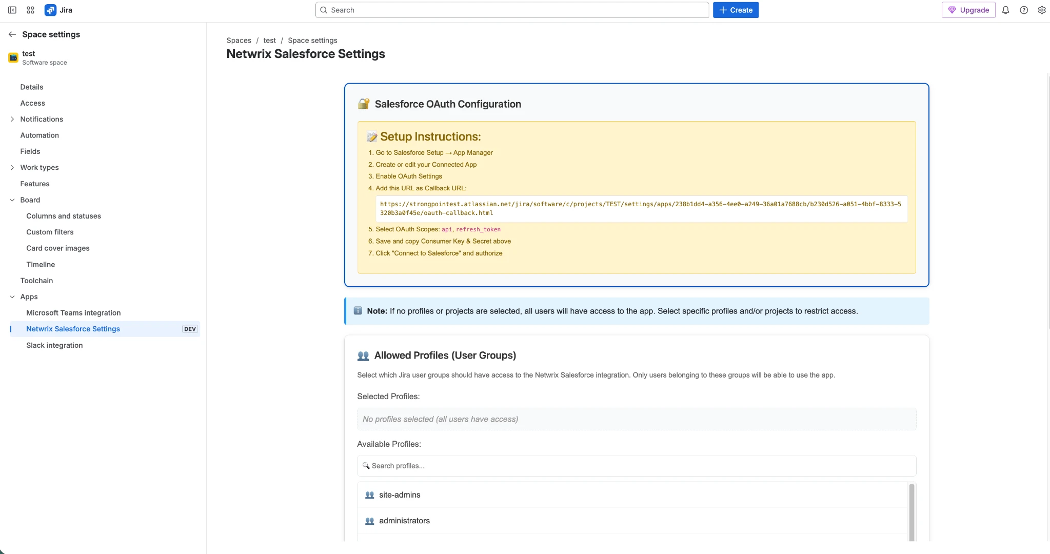

  1. Open a Jira project.
  2. Select Space Settings.
  3. Select the Netwrix Salesforce Settings tab. There are two lists: Allowed Profiles (User Groups) are all of the current groups in Jira Allowed Projects are projects that can see the Strongpoint for Salesforce Jira integration. If Selected Profiles and Projects are blank, all groups have access to the integration.
    Newrix Settings Page
  4. Select an existing group and click Add to include it as a Selected profiles. To remove a group from the selected list, select it and click Remove. If Selected projects is blank, all groups have access to the integration. If there are one or more groups, then access is restricted to the specified group.
