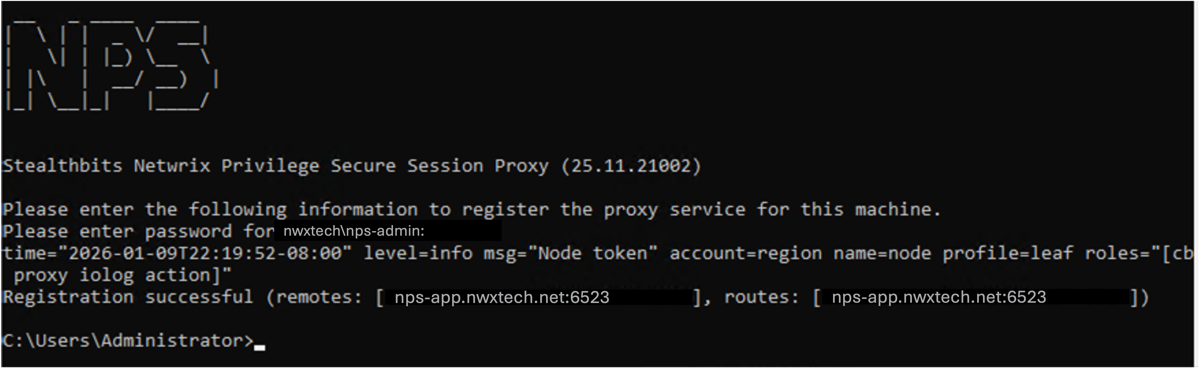

Step 4 – On the remote proxy server, run the following command from an elevated command prompt:
"C:\Program Files\Stealthbits\PAM\ProxyService\sbpam-proxy.exe" register -s [NPS Application Server IP Address] -u [Privilege Secure Admin Account in NT-Style format] -H [Hash from the NPS Application server]
For example:
"C:\Program Files\Stealthbits\PAM\ProxyService\sbpam-proxy.exe" register -s 192.168.99.1 -u nwxtech\nps-admin -H eb367841c099c0338cee72ed572c7b5539f68fa215f7598c0ef5dcc067ee729c
Proxy Registered
The Privilege Secure Proxy Service is now registered with the Privilege Secure application.
