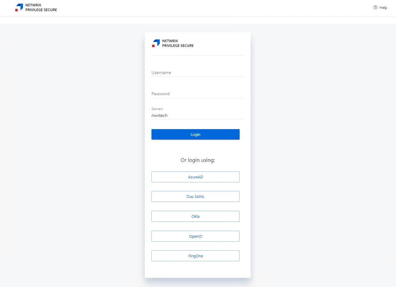

Default Login

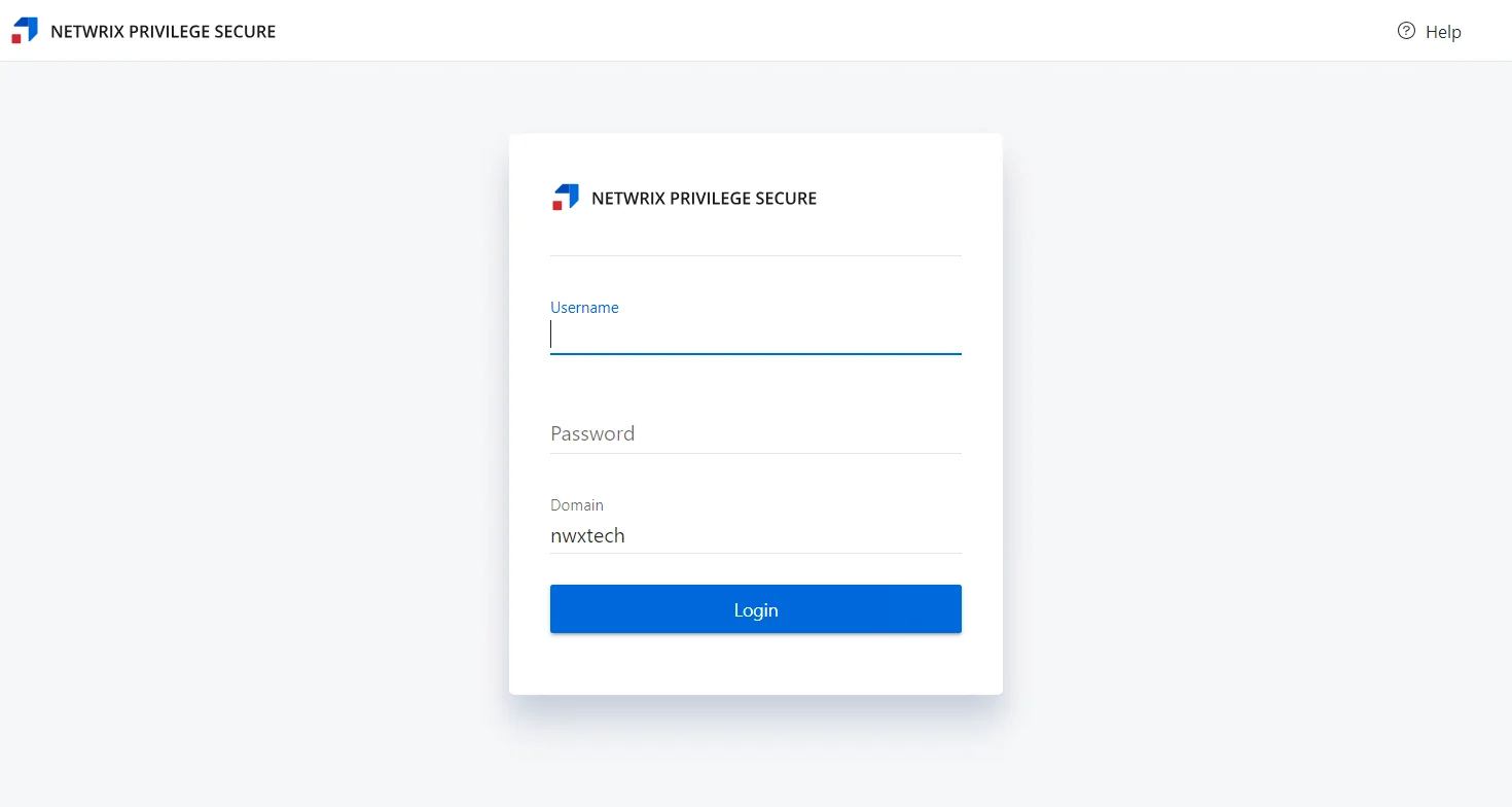

Step 2 – Either click the default authentication connector button, or click Log In with a Different Account to display all of the authentication connectors that are registered with Privilege Secure.
Alternate Login
Step 3 – Login to the Privilege Secure Console with a configured authentication connector, or enter the user credentials.
Step 4 – Click Login to proceed.

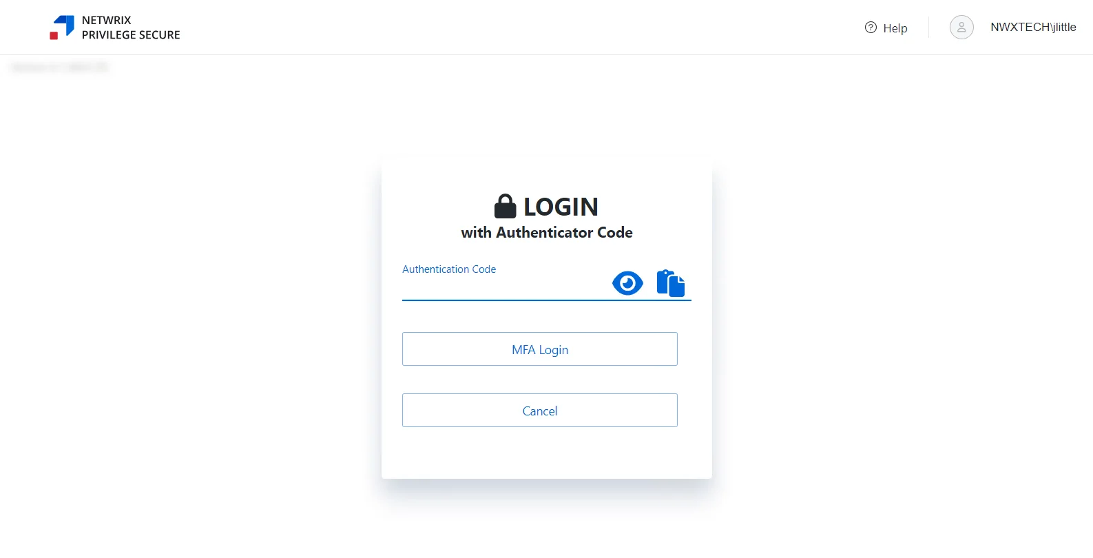

Step 5 – Enter the code provided by the registered multi-factor authenticator (MFA).
Multi Factor Authentication Login

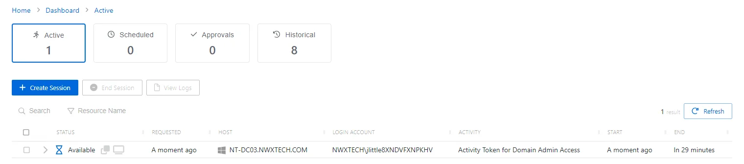

Step 6 – Click MFA Login. The Privilege Secure Console opens on the Dashboard Interface.
Dashboard Interface
The Privilege Secure Console is ready to use. Note that the option to view the recovery codes is no longer available after the initial login. From here, create Sessions and Access Policies, manage Users and Resources, and review usage data.
