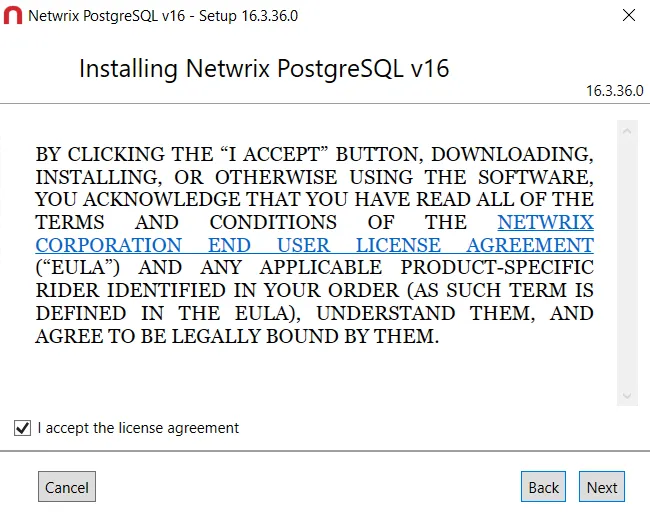

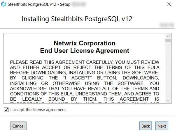

Step 3 – On the End User License Agreement page, check the I accept the license agreement box and click Next.
Remember, it is a best practice to read the agreement before accepting it.

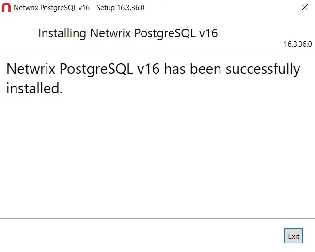

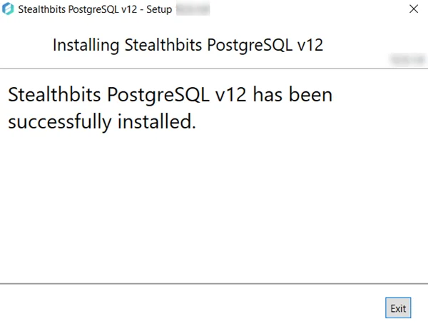

Step 5 – When installation is complete, click Exit. The Stealthbits PostgeSQL v12 Setup wizard closes.
A reboot may be required.
The PostgreSQL database is successfully installed. It is time to install the application.

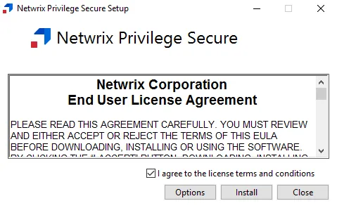

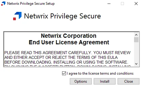

Step 2 – On the End User License Agreement page, check the I agree to the license terms and conditions box and click Options.
