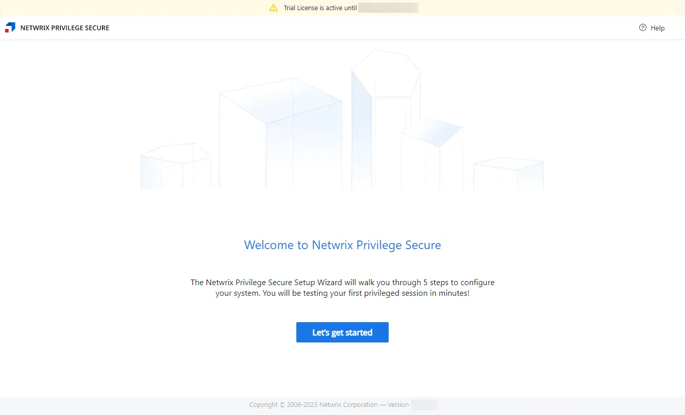

Step 1 – Launch the Setup Wizard.
Step 2 – Click Let's get started.
