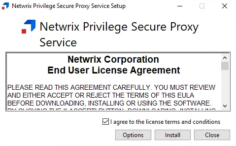

Step 2 – Right-click on the installer and select Run as administrator. The Netwrix Privilege Secure Proxy Service Setup wizard opens.
Netwrix Privileged Secure Proxy Service Setup wizard on the EULA page
Step 3 – On the End User License Agreement page, check the I agree to the license terms and conditions box and click Options.
