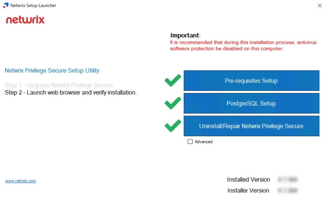

The Netwrix Setup Launcher can be closed, if it was used during installation.

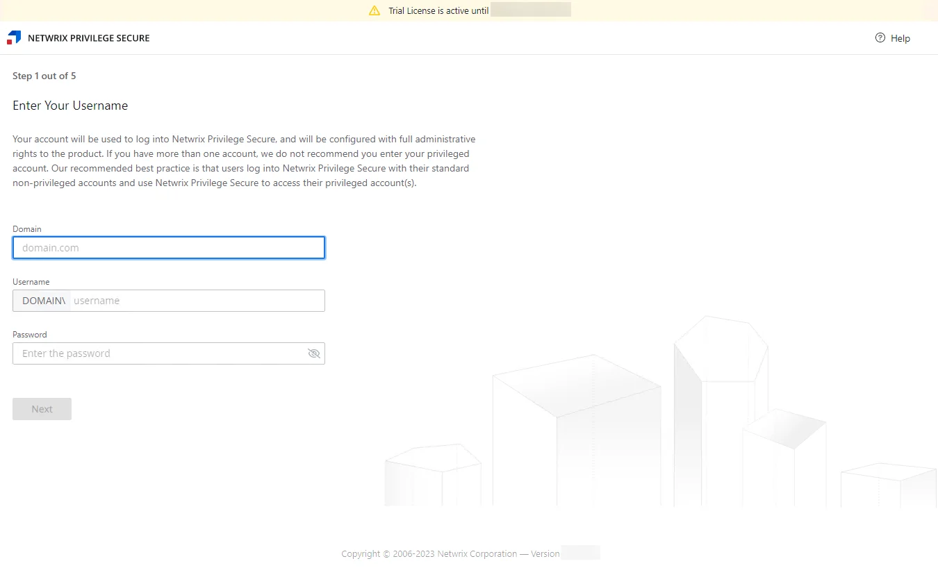

Step 3 – On the Step 1 page, you identify your primary application Administrator account. Enter the following information and then click Next:
- Domain – Enter the account's domain in
domain.com
format - Username – Enter the account. The domain will auto-populate from the field above.
- Password – Enter the account's password. The eye icon can be used to view the entry.

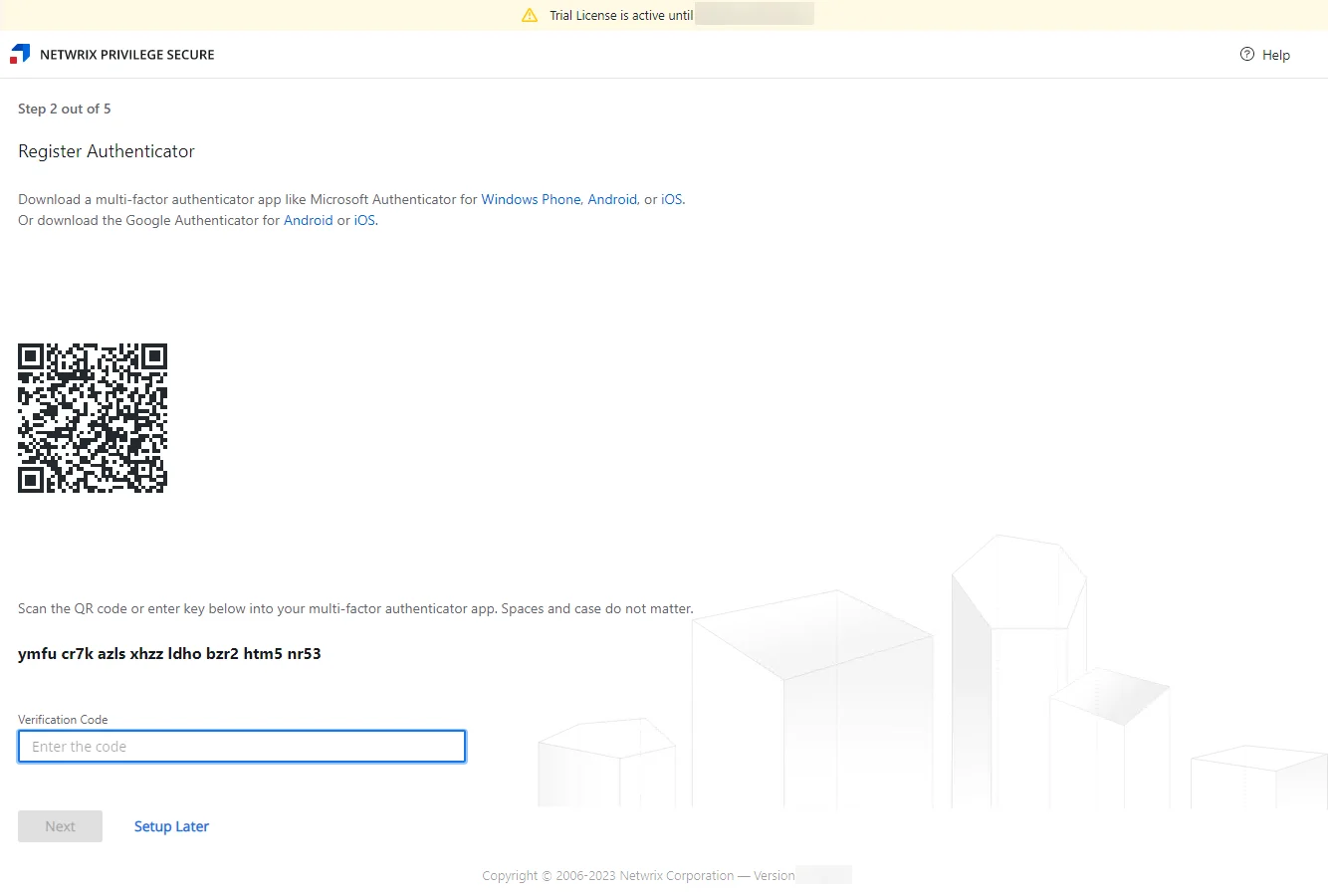

Step 4 – On the Step 2 page, you register your primary application Administrator account with an MFA provider.
Scan the QR code or manually enter the provided key into the MFA phone app. The MFA will provide a verification code.
Enter the verification code in the textbox.
Click Next, while the code is still active.
NOTE: MFA for this account can be done at a later time through the User details page. If that is desired, click Setup Later and skip to Step 6 of these instructions. The initial account will be set to Not Required MFA. See the User, Group, & Application Details Page topic for additional information.

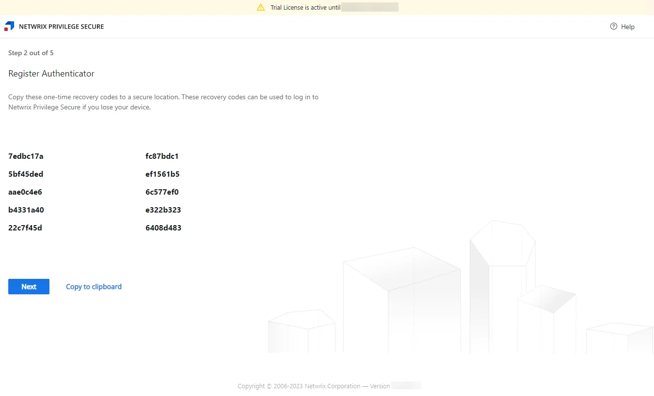

Step 5 – One-time recovery codes are provided for the registered authenticator. It is recommended to copy these codes with the Copy to clipboard link and save them in a secure location in case you lose your phone with the authenticator app. Click Next.

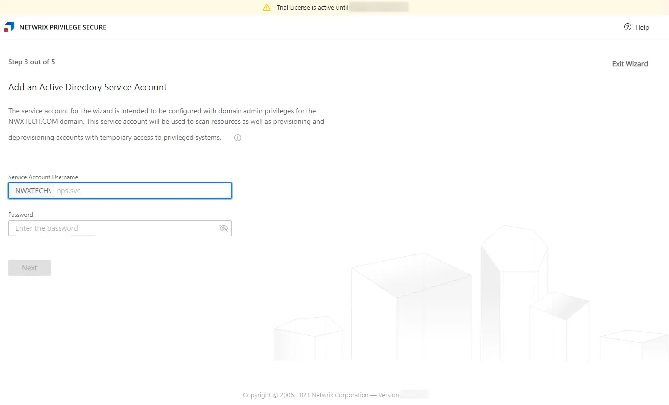

Step 6 – On the Step 3 page, you identify the Active Directory service account with domain administrator privileges. Enter the following information and then click Next:
- Username – Enter the account. The domain will auto-populate from the Step 1 page.
NOTE: This service account will be used to run domain synchronization. If you do not have an account with domain administrator privileges ready when walking through the Setup Wizard, you can click the Exit Wizard link. See the Exit Wizard Early topic for additional information.

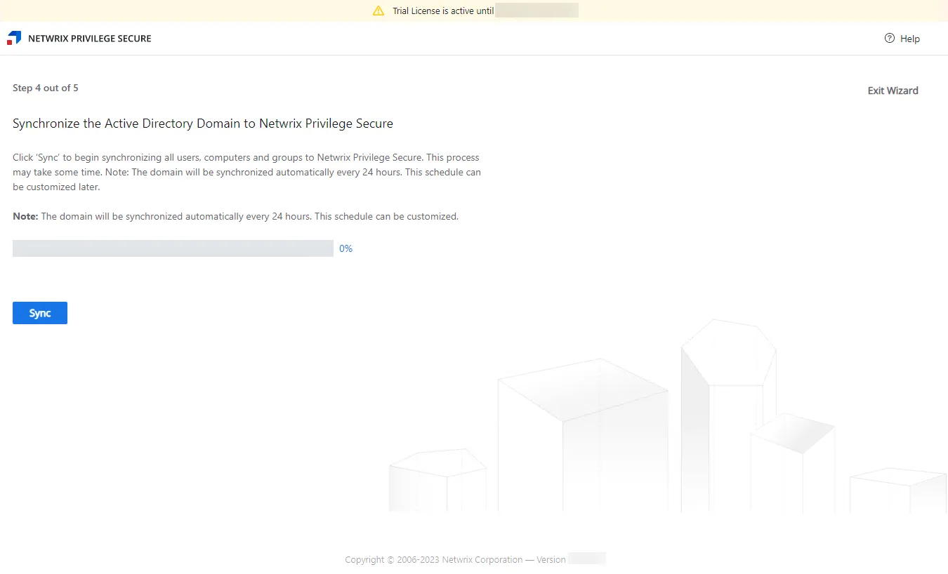

Step 7 – On the Step 4 page, click Sync. The Active Directory domain synchronization begins and is tracked by the status bar. When synchronization is complete, the Step 5 page opens.
NOTE: Problems with service registration may occur if accessing the wizard from a remote IP address. If this does occur during domain synchronization, you will be redirected to a dedicated error page, which allows you to ignore certificate errors during the initial configuration.

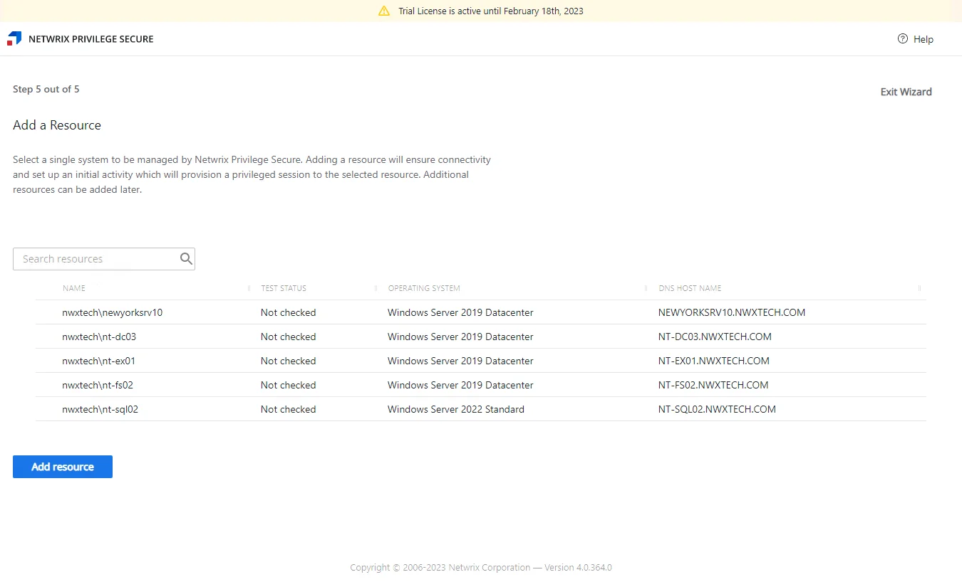

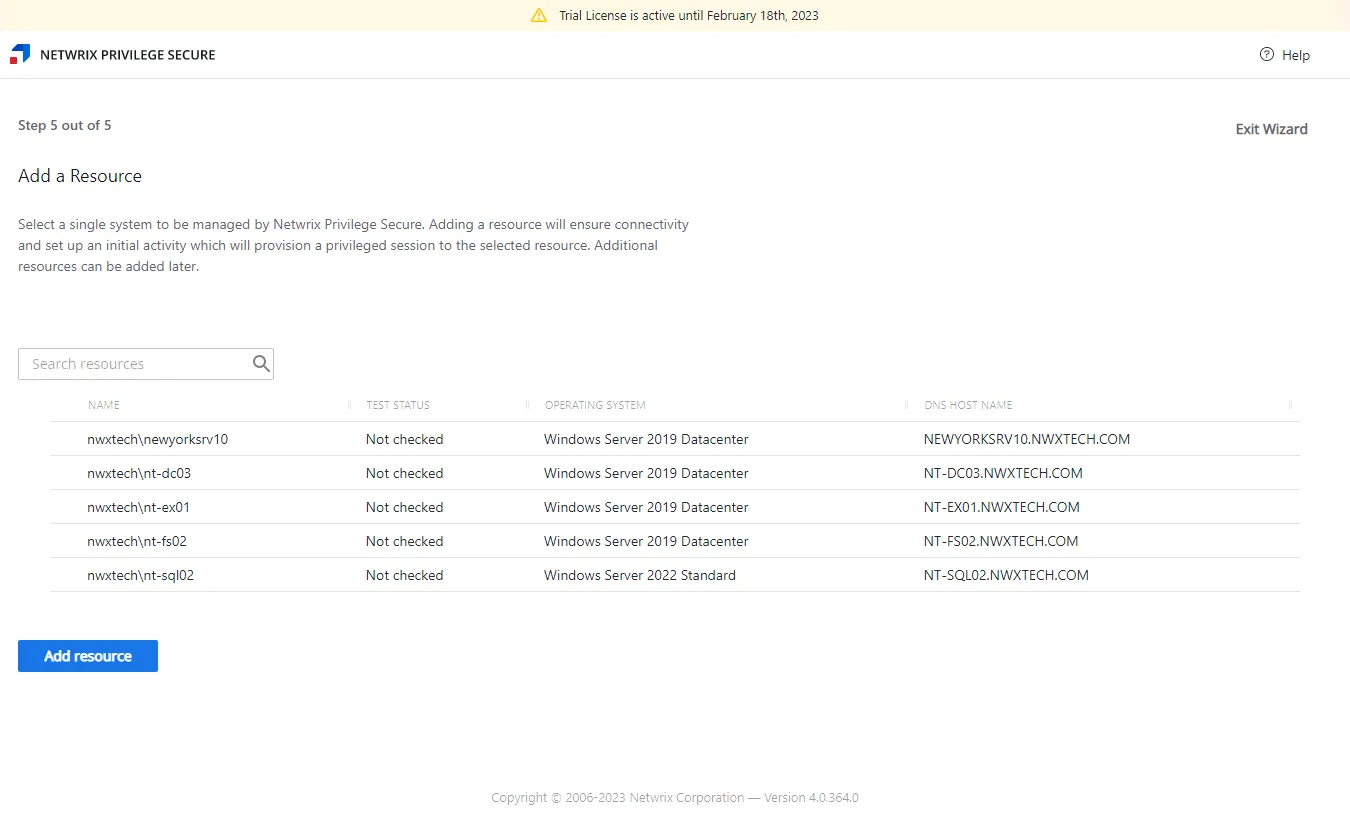

Step 8 – On the Step 4 page, select the first resource to be onboarded. The Setup Wizard will create your first access policy to grant Domain Admin Access with an Activity Token to this resource. The selected resource displays a green checkmark at the beginning of the row. Click Add resource.
NOTE: Available resources were discovered on the domain during the synchronization completed on the Step 3 page. You can use the Search resources box to filter the list.
Step 9 – The Check resources window opens. The application is checking DNS resolution and WinRM requirements. If a test fails you can fix the configuration and click Retest. To cancel the test, click Close. When all tests are successful, the window and the Setup Wizard close automatically.

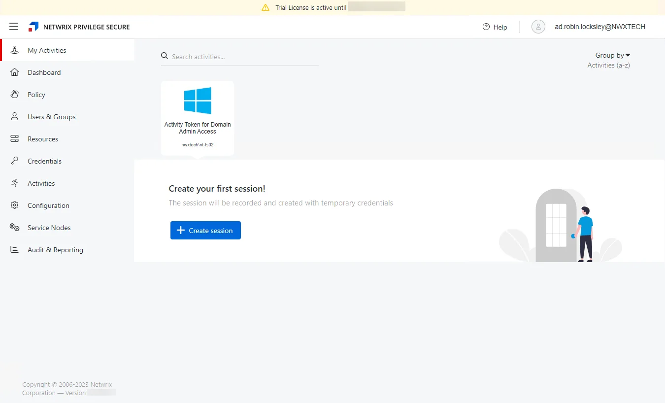

When the Setup Wizard closes, you are redirected to the My Activities interfacing . The activity created by the Setup Wizard, Activity Token for Domain Admin Access, is displayed.
Take a Product Tour of the console or onboard more users and resources. See the Getting Started topic for additional information.
