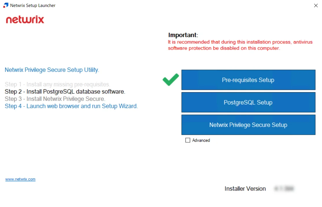

The Netwrix Setup Launcher checks for and installs missing prerequisites in addition to installing the database and application.
Netwrix Setup Launcher showing the Prequisites Setup with a green checkmark
RECOMMENDED: Antivirus software should be disabled on this computer during the installation.
Right-click on the NPS_Setup.exe file and select Run as administrator. The Netwrix Setup Launcher will open. The launcher runs a prerequisites setup check. The green checkmark indicates the prerequisites have been met and you are ready to install the database.

Step 1 – In the Netwrix Setup Launcher, click Install PostgreSQL 12. The PostgeSQL v12 Setup wizard opens.
NOTE: If PostgreSQL v12 is already installed, a green checkmark is displayed to the left of the Install PostgreSQL 12 button and you can install the Privilege Secure application.

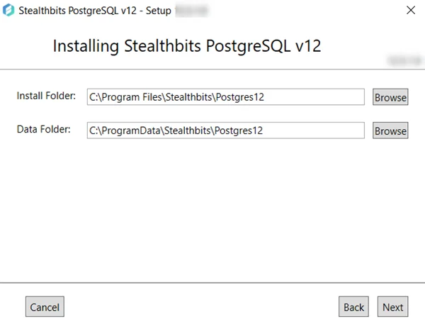

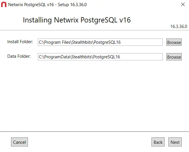

Stealthbits PostgreSQL v12 Setup Wizard on the Install and Data Folder page
Step 4 – The default installation location for both the Install Folder and the Data Folder is:
C:\Program Files\Stealthbits\Postgres12
  • To change the default location, click Browse and set a new location.
  • When the location is set, click Next.
NOTE: The installation process begins and the Setup wizard displays the its Progress. This may take a few moments.

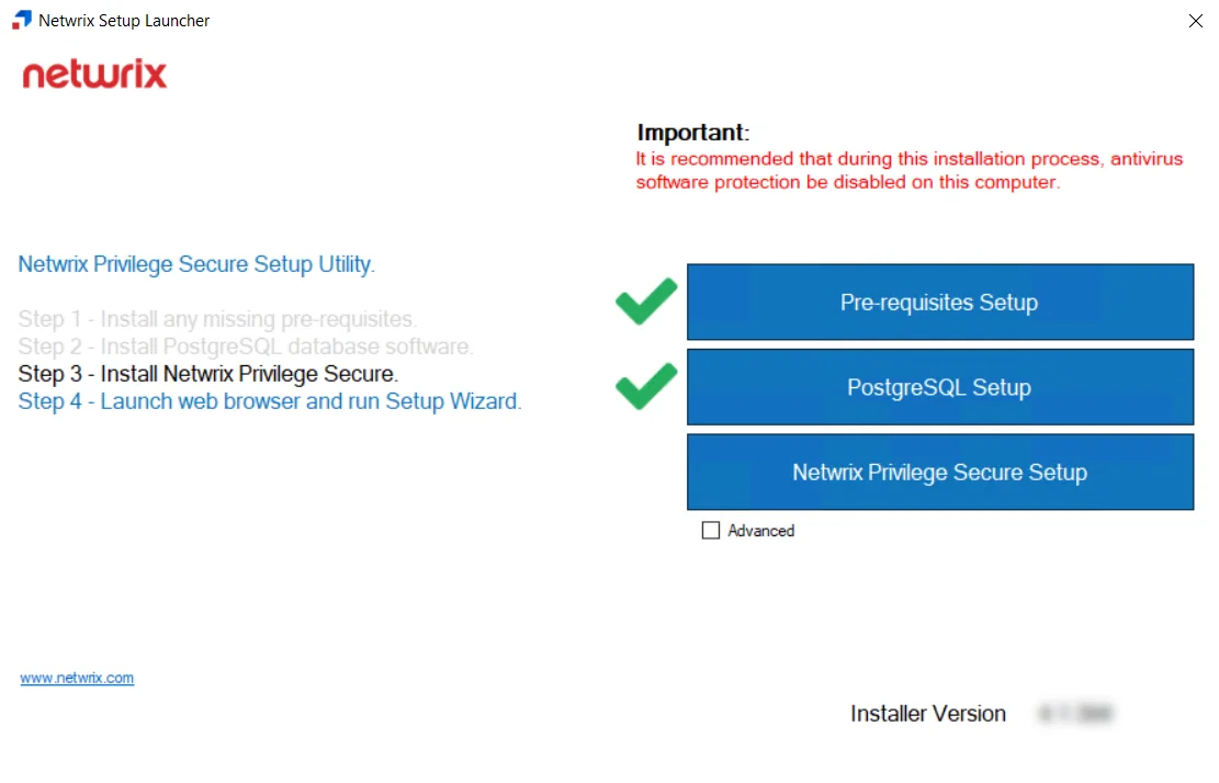

Netwrix Setup Launcher showing the PostgreSQL Setup with a green checkmark
Step 1 – If you are using the Netwrix Setup Launcher, it displays a green checkmark for the PostgreSQL Setup. Click Netwrix Privilege Secure Setup.
NOTE: This window remains open in the background while the database is installed.

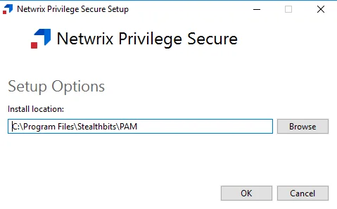

Step 3 – The default installation location for Install Folder is:
C:\Program Files\Stealthbits\PAM
  • When the location is set, click OK.
Step 4 – You will return to the End User License Agreement page. Click Install.
