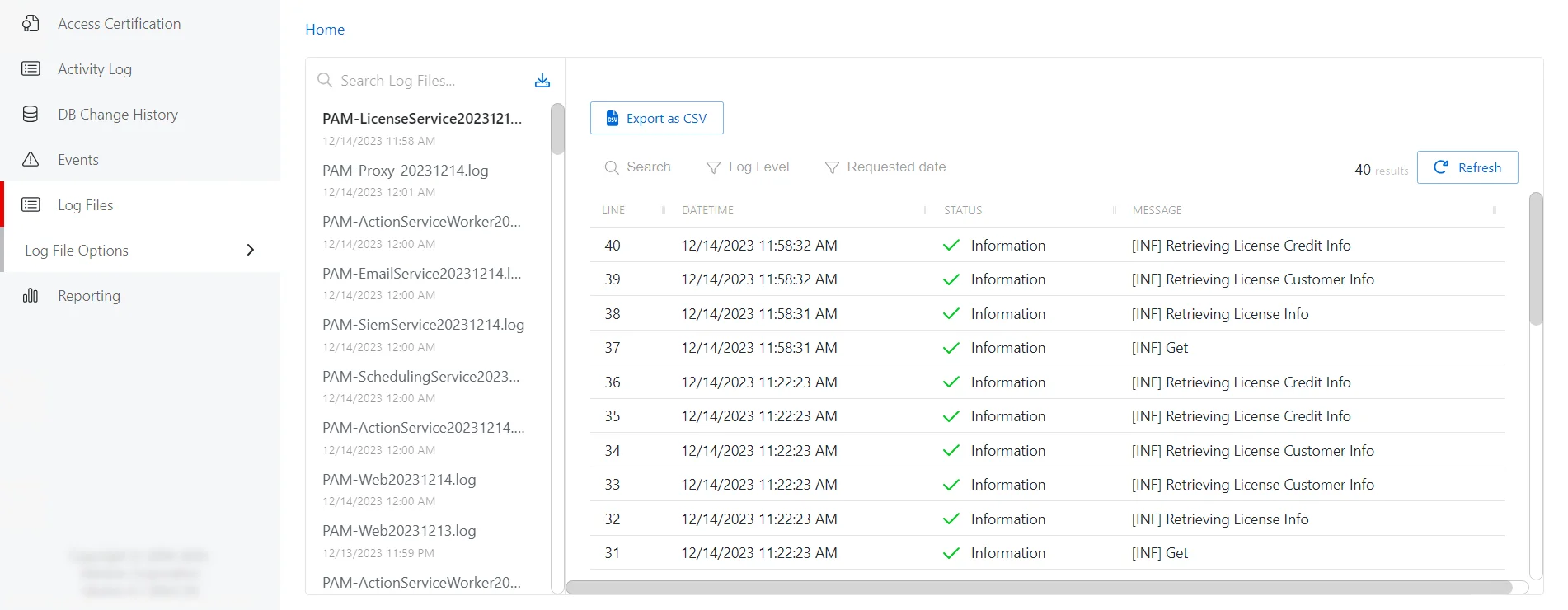

The Logs page shows the log files. From here, search and investigate the records.
Audit and Reporting Log Files Page
On the left of the page, the Log list shows the log files:
  • Search – Searches the table or list for matches to the search string. When matches are found, the table or list is filtered to the matching results.
  • List of Log files – Select a log file from the list to view it contents
The right of the page shows the contents of the selected log file and has the following features:
  • Search – Search the contents of the log file
  • Oldest/Newest Are At The Top button – Click to toggle the list by ascending or descending order
  • Go To Top button – Return to the top of the list
  • List of log entries – Itemized lines from log entry file
