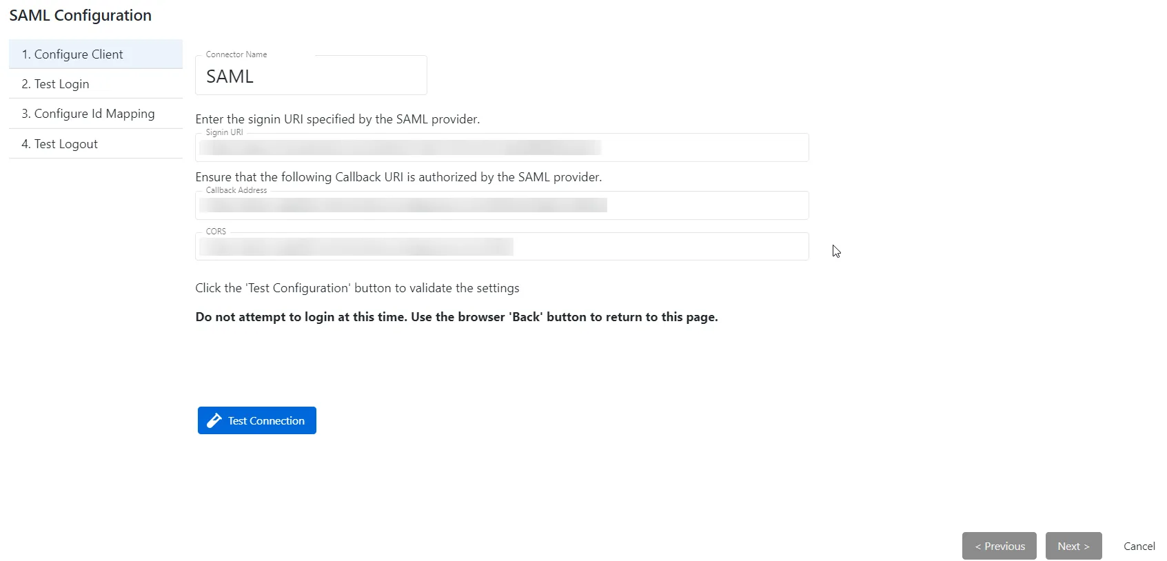

Step 3 – On the Configure Client page, enter the following information:
Signin URI– The SAML provider issuer URI. Out-going redirection requires the correct “Issuer” path to be set. Incorrect settings will generally result in a 404 error.
Callback Address – The SAML provider requires the Privilege Secure callback path to be authorized. Generally this is displayed by the provider after redirection. Enter the address and port of the Privilege Secure server:
[protocol]//[hostname]:[port]/callback
CORS – The SAML provider requires the Privilege Secure callback location to be configured for CORS. This will either be displayed by the provider after redirection, or a 500 error is returned. If an error is returned, CORS is probably not configured with the correct information. Enter the address and port of the Privilege Secure server:
In the next step, verify that the Sign In page displays as expected, but do NOT sign in at this step.
Step 4 – Click Test Connection to verify the connection configuration. This opens the Sign In page in the browser. Do NOT sign in.
- If the Sign In page does not display as expected, review the values configured for the SAML connector and modify them where needed. Then, verify the Sign In page again.
Step 5 – Click the browser’s back arrow to return to the Configure Client wizard page.
Step 6 – If the Sign In page displayed as expected, click Next.
