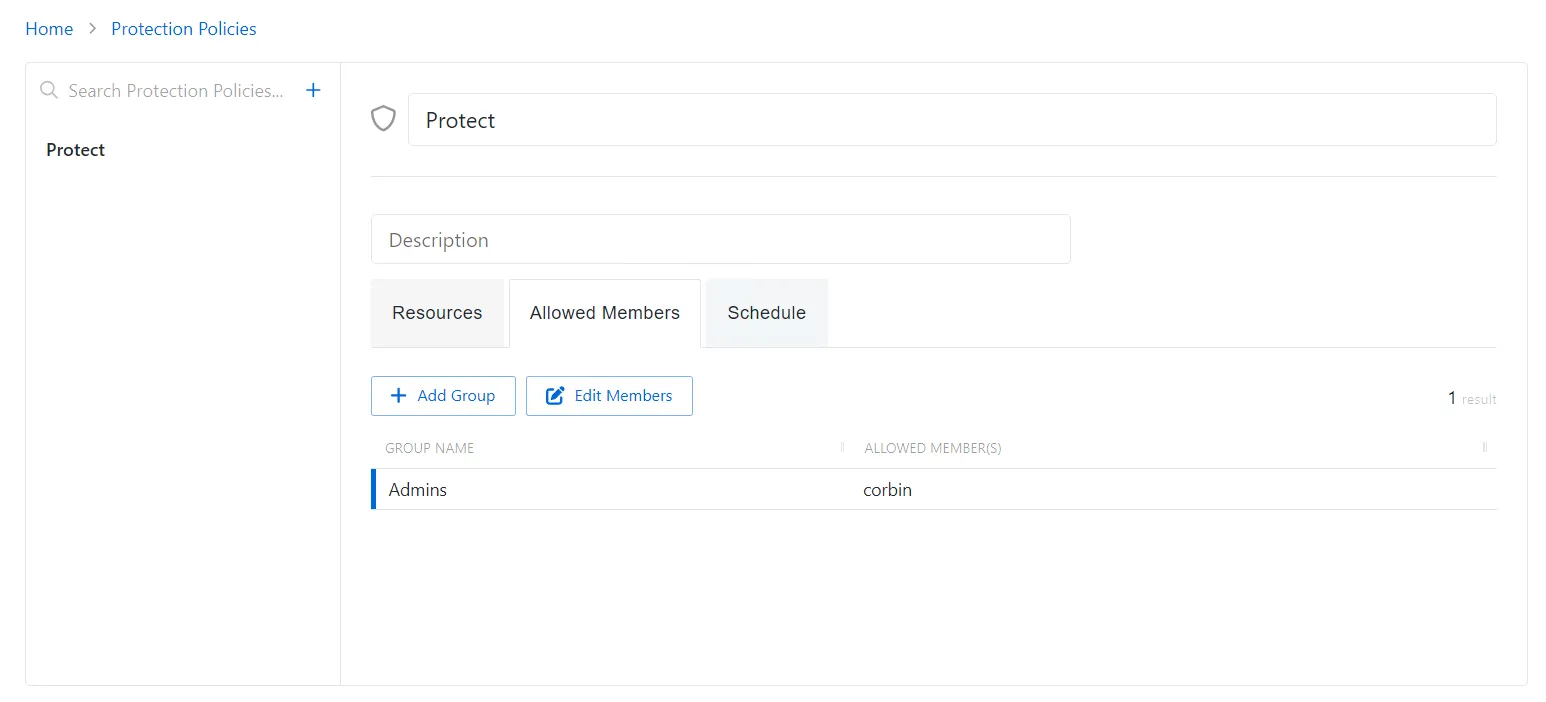

Allowed Members Tab for Protection Policies
The Allowed Members tab shows the configuration options for managing the groups governed by the selected protection policy. Any group member(s) discovered that are not in the list will be removed from the local group on the resource during the next scheduled sync.
Protection Policy Allowed Member Tab
The Allowed Members tab has the following features:
  • Add Group — Opens the Add Protected Group and Member window. See the Add Groups to a Protection Policy topic for additional information.
  • Edit Members — Opens the Edit Protected Group Members window to edit the selected group within the protection policy. See the Edit Protected Group Members topic for additional information.
  • Group Name — Displays the name of the group
  • Allowed member(s) — Authorized account that will not be removed from the local group when the protection policy runs. If a domain is not specified in the name, the account is assumed to be local to the resource.
