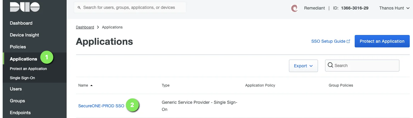

Duo: Create the DUO Application for Privilege Secure

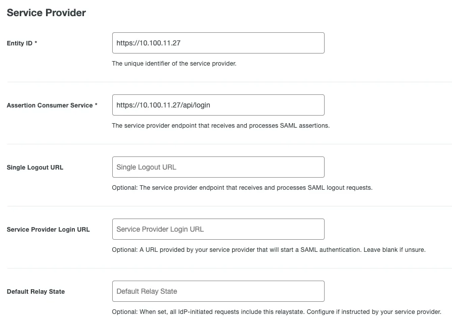

Scroll down to the Service Provider Section; notes:
  • The information below is for example purpose only.  Enter the appropriate information for your environment.
  • https://10.100.11.192 should be replace with your Privilege Secure URL.
  • Entity ID can by any unique string.  We recommend using your Privilege Secure URL.

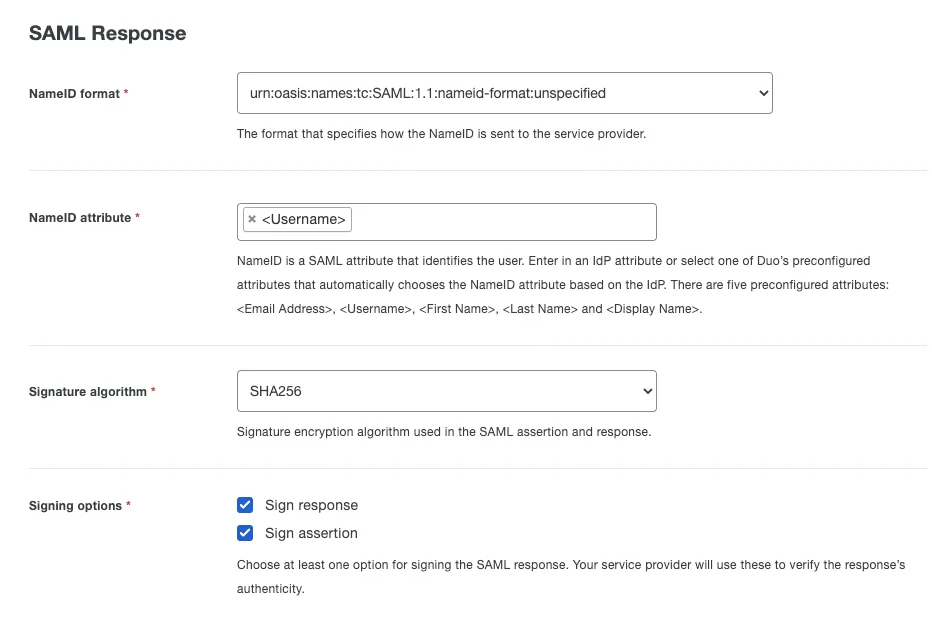

SAML Response Section Notes:
  • The NameID can also be:
    urn:oasis:names:tc:SAML:2.0:attrname-format:unspecified

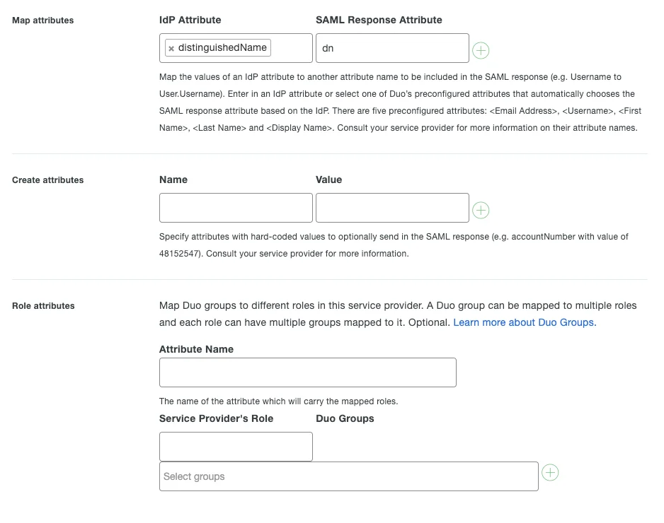

  • The 'idP Attribute' and 'SAML Response Attribute' will need to be manually entered.
  • idP Attribute: distinguishedName
  • SAML Response Attribute: dn
  • The remaining SAML Response section fields can be left blank.

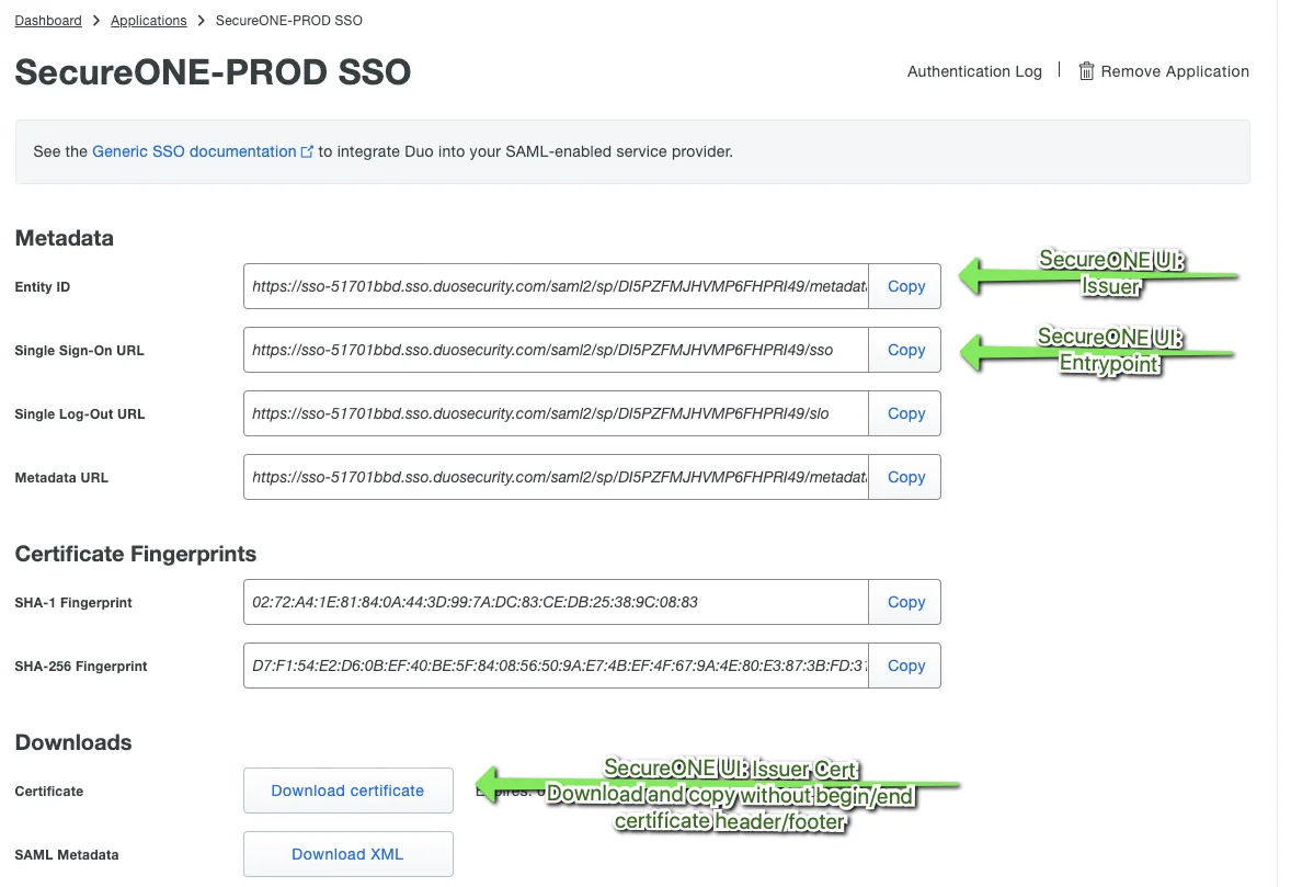

Duo: Retrieve SAML/SSO Information for Privilege Secure

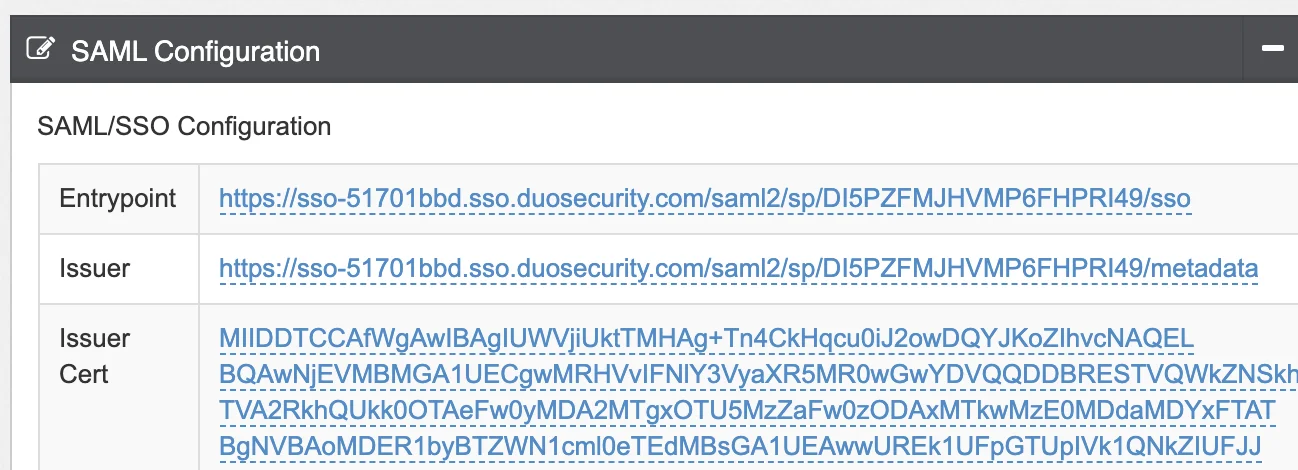

Enter SAML/SSO Information
Enable SSO in Privilege Secure and Login Example
At the bottom of the Configure > Server > SAML Configuration Panel, enable or disable SSO when appropriate:
Step 1 – Click SSO Login button to log in via Duo.
Step 2 – *Optional:  To login from Duo first (IdP-initiated), use the Single Sign-On URL provided by Duo.  This is found in the application's "Metadata" section.
