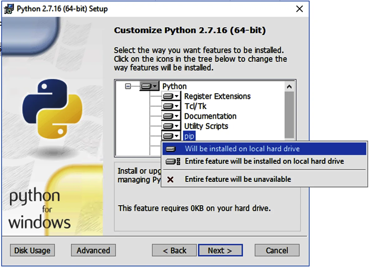

During the install of Python setup process, on the "Customize Python" window, the "pip" feature is selected and showing "Will be installed on local hard drive" (screenshot below).
You also need to check "Add Python to environment variables" and "Include Python on filepath".
