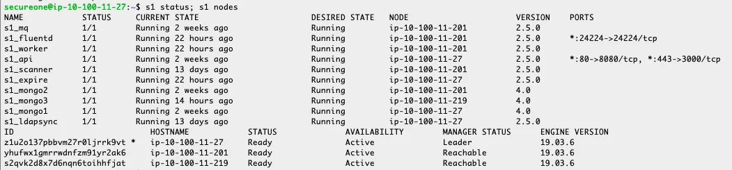

Privilege Secure Processes (suggested daily)
  • The Privilege Secure processes can be listed using the following command:
  • s1 status; s1 nodes
  • This lists the status of all containers in the docker environment for Privilege Secure. They should all be scaled to 1/1 in a production environment. All nodes should be listed
  • The manager status should be listed as "Leader" for a single node or "Leader" and "Reachable" as above. The Leader is the primary manager node and the Reachable nodes are managers. In the event of a failure of a node an election to determine a new primary manager takes place. A single node can fail without any indication to users.
