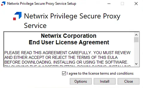

Step 1 – Copy the NPS.ProxyService.exe file to the desktop of the remote server.
Step 2 – Right-click on the installer and select Run as administrator. The Netwrix Privilege Secure Proxy Service Setup wizard opens.
Step 3 – On the End User License Agreement page, check the I agree to the license terms and conditions box and click Options.
Remember, it is a best practice to read the agreement before accepting it.
Step 4 – The default installation location for Install Folder is:
C:\Program Files\Netwrix\Netwrix Privilege Secure Proxy Service
- To change the default location, click Browse and set a new location.
- When the location is set, click OK.
Step 5 – You will return to the End User License Agreement page. Click Install.
The installation process begins and the wizard displays the its Progress. This may take a few moments.
Step 6 – When installation is complete, click Close.
