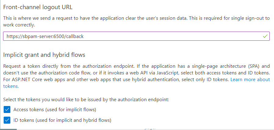

  5. In the left sidebar, click Authentication. Scroll down and enter the same Callback Address from Step 3 in the Front-channel logout URL field.
    Enable the following checkboxes:
    • Access tokens (used for implicit flows)
    • ID tokens (used for implicit and hybrid flows)
    Authentication settings with token options enabled
  6. Click Save at the top of the page, then return to the app's Overview page.

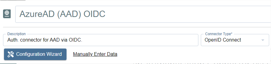

  1. As a Netwrix Privilege Secure administrator, navigate to Configuration > Authentication and click the green + button to add a new Authentication Connector.
  2. Enter a name and (optionally) a description for the new connector. Set the Connector Type to OpenID Connect.
    Authentication Connector creation dialog with OpenID Connect selected
  3. Click Configuration Wizard.

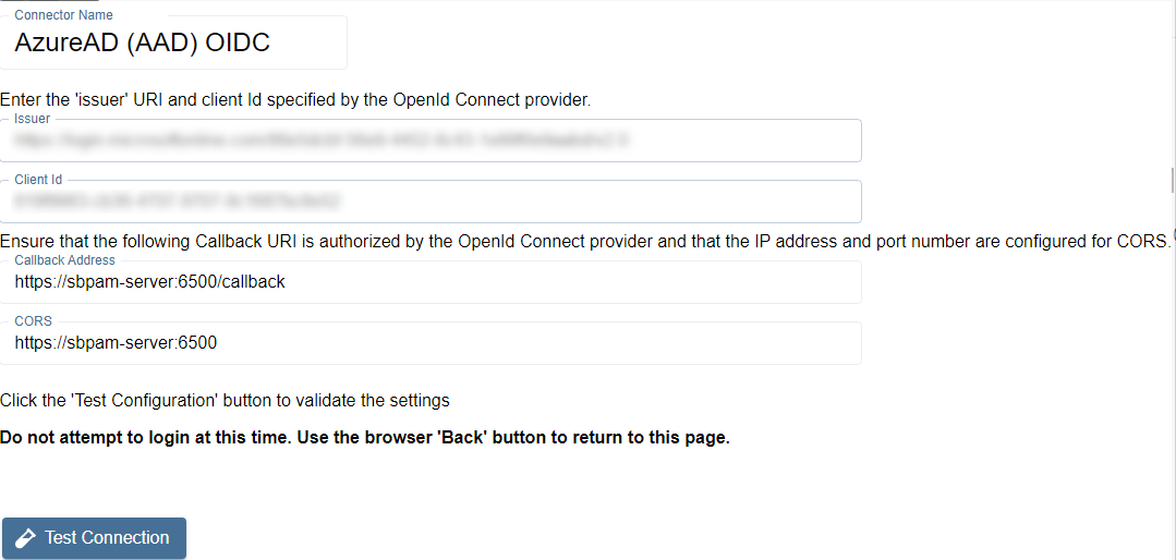

  4. On the wizard's Configure Client page, enter the Issuer and Client ID (from the Steps for Microsoft Entra ID) in the respective fields.
    Configure Client page with Issuer and Client ID fields
  5. Click Test Connection.
    On the Microsoft Entra ID sign-in page that loads, do not sign in. Once you have verified that the sign-in page loaded properly, click the back button in your browser to return to Netwrix Privilege Secure. The connection test is successful if Microsoft Entra ID did not display an error.

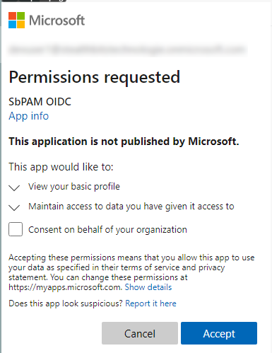

  7. Click Login and sign in as any Microsoft Entra ID user (this does not need to be an administrator). You are prompted to accept the app's requested permissions. Check Consent on behalf of your organization and click Accept.

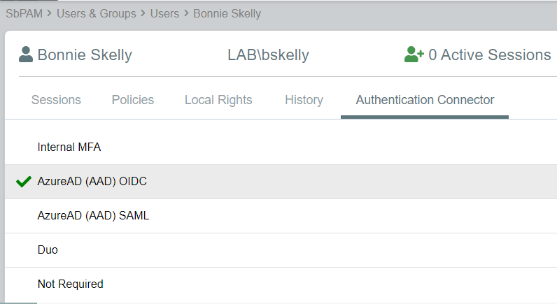

  12. You can now assign this authentication connector to a user via the Authentication Connector tab for a user accessed in Netwrix Privilege Secure's Users & Groups page.
    Authentication Connector assignment in Users &amp; Groups page
    Users with this authentication connector assignment can now use this authentication connector option on the Netwrix Privilege Secure log-in screen.
