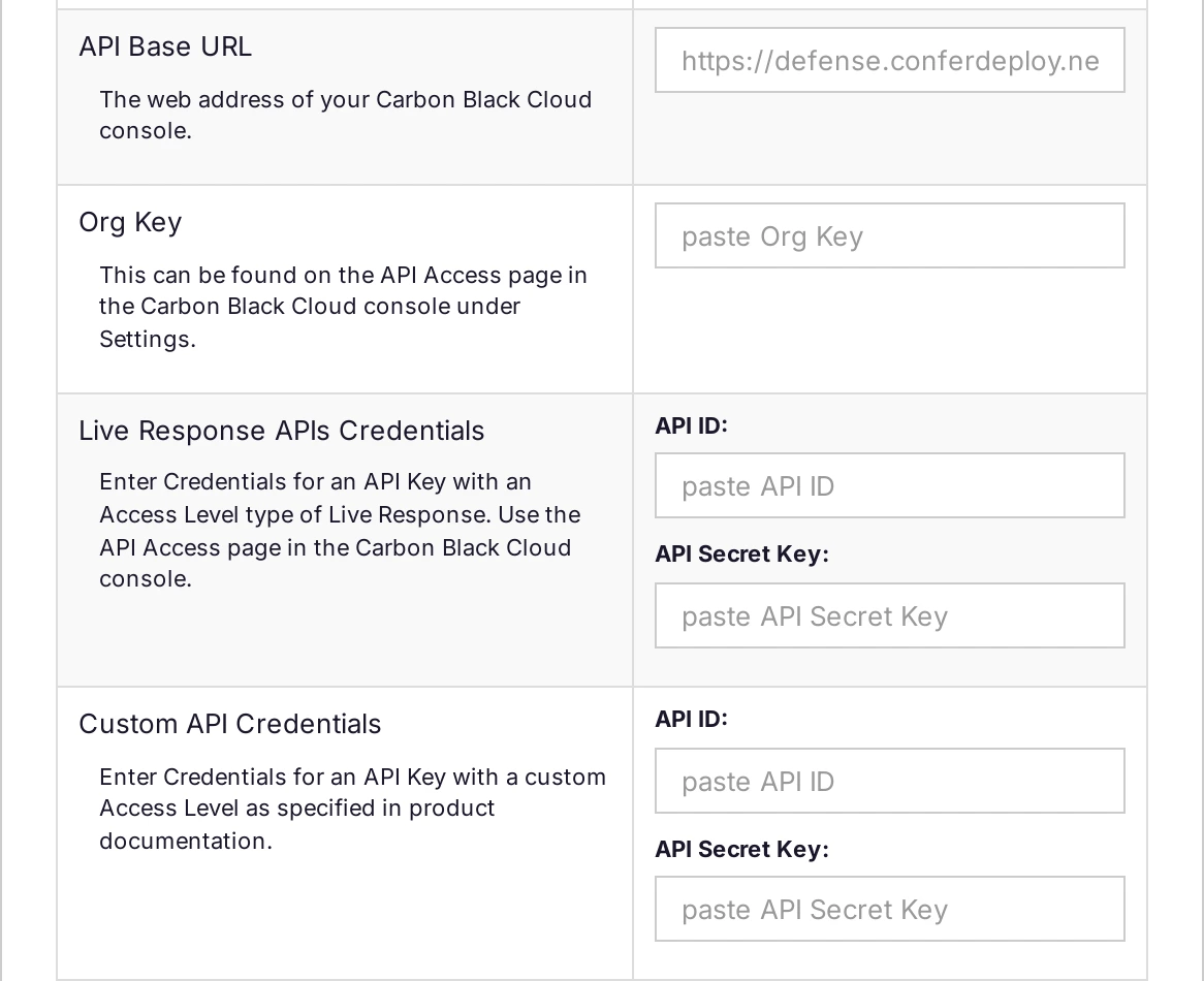

  7. Enter the API Base URL of your Carbon Black Cloud console, for example https://defense.conferdeploy.net.
  8. Enter the Org Key.
  9. Under Live Response APIs Credentials, enter the API ID and API Secret Key of the Live Response key. The form requires these values, but the product doesn't use them at run time.
  10. Under Custom API Credentials, enter the API ID and API Secret Key of the custom key. The product signs every request with this key.
    The Carbon Black Cloud provider form with the API Base URL, Org Key, Live Response APIs Credentials, and Custom API Credentials fields
  11. Select Test Connection. The product shows <name> EDR Integration configuration validated successfully. when the connection works.
  12. Select Save.
