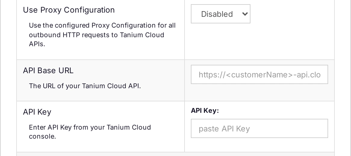

Add the provider configuration​
  1. In Privilege Secure for Discovery, select Configure > Server.
  2. In EDR Provider Configuration, select Add Provider.
  3. Set Provider to Tanium Cloud.
  4. Enter a Configuration Name.
  5. Under Remote Systems Management, set Enable to Enabled.
  6. Set Use Proxy Configuration to Enabled if the server reaches Tanium through a proxy.
  7. Enter the API Base URL, in the form https://<customer-name>-api.cloud.tanium.com.
  8. Enter the API Key, the token from Tanium.
    The Tanium Cloud provider form with the Use Proxy Configuration, API Base URL, and API Key fields
  9. Enter the Token Expiry, the expiration date of the token. Privilege Secure for Discovery can't read the date from Tanium. This value doesn't extend or rotate the token.
  10. Select Test Connection. The product shows <name> EDR Integration configuration validated successfully. when the connection works. This test checks only that the API is reachable and that the token is valid. It doesn't check the sensor, the package, the computer group, or action deployment.
  11. Select Save.

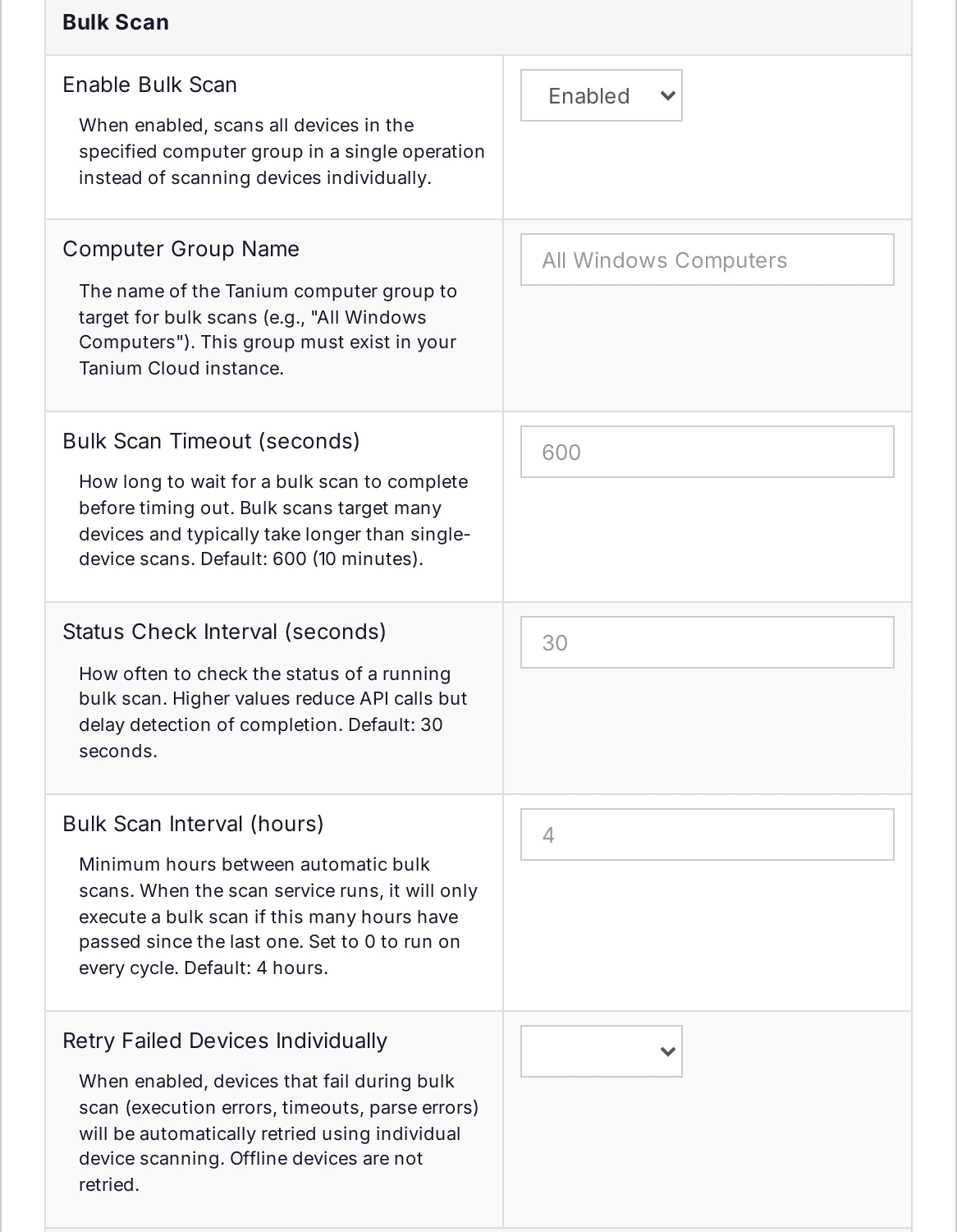

Configure bulk scanning​
A bulk scan reads every device in a Tanium computer group with one action instead of scanning each device in turn. The number of Tanium API calls stays small no matter how many devices the group holds.
The scan runs on every device in the group. The product matches each result to a system by its fully qualified domain name or host name, regardless of the provider that the system uses. Assigning the configuration to systems doesn't limit the group, and choosing the group doesn't assign its members. If the group holds devices that the product doesn't manage, the action runs on those devices, and a result can match the wrong record or none.
Create a dedicated Tanium computer group that holds only the intended systems. Start with a small static group. Then compare names, not only counts. Confirm that every device in the group is a system assigned to this configuration, and that every system assigned to this configuration is in the group.
  1. Edit the Tanium Cloud configuration.
  2. Set Enable Bulk Scan to Enabled.
  3. Enter the Computer Group Name. The group must exist in Tanium Cloud. The form requires a name when bulk scanning is on. Exclude domain controllers, duplicate records, and devices whose host names are ambiguous.
  4. Adjust the optional settings.
    The Bulk Scan section of the Tanium Cloud provider form
    SettingDefaultPurpose
    Bulk Scan Timeout (seconds)600How long to wait for a bulk scan to finish.
    Status Check Interval (seconds)30How often to check a running bulk scan.
    Bulk Scan Interval (hours)4The minimum time between automatic bulk scans. It's not a fixed start time. Enter a positive whole number.
    Retry Failed Devices IndividuallyDisabledScans devices that the bulk scan didn't read successfully one at a time. This includes OFFLINE devices. Leave it disabled for the first bulk scan, and enable it after per-system scans work.
  5. Select Save.
Bulk scans run as part of the regular scan cycle, before the per-device scans. Rescan and Scan Systems scan one system and don't start a bulk scan. If Retry Failed Devices Individually is enabled, devices that the bulk scan couldn't read return to per-device scanning.
In each scan cycle that runs a bulk scan, the product skips the per-device scan for every system that uses the configuration, including systems that aren't in the computer group. A bulk scan collects inventory only. It doesn't run Protect, OAM, password rotation, or account changes. If a system needs those policy actions during every scan cycle, don't enable bulk scanning for its configuration.

No bulk scan appears in Bulk ScansConfirm that the provider and Enable Bulk Scan are enabled and saved, that Computer Group Name is exact, that systems are assigned to the configuration, and that Bulk Scan Interval (hours) has passed since the last run. Bulk scans start in the regular scan cycle, not when you select Rescan.
A bulk scan finishes but no devices updateThe computer group name doesn't match, or the group is empty. Compare Computer Group Name with the group in Tanium.
Unmatched is more than 0, or the device count differs from what you expectCompare the exact members of the computer group with the systems assigned to the configuration. Check fully qualified domain names, duplicate records from hybrid synchronization, and repeated host names.
A bulk scan is Completed but inventory is missingCompleted doesn't mean that every device succeeded. Check the device counts, the Unmatched value, and the result for each device. Then open the affected system.
Failed devices weren't scanned one at a timeRetry Failed Devices Individually is disabled. Enable it. The product must still match the device to a system and connect to it.
Protect or OAM didn't run after a successful bulk scanA bulk scan collects inventory only, and it skips the per-device scan that runs these actions. Disable bulk scanning for the configuration, and contact Netwrix Support.
A saved rate limit or interval value changes or disappearsThe product doesn't save the rate limit fields. Use a positive whole number for Bulk Scan Interval (hours), and open the configuration again after you save it.
Circuit breaker is open in the logsRepeated Tanium API failures paused bulk scans for 60 seconds. Fix the cause, then wait for the next scan cycle.
Timeouts during a bulk scanIncrease Bulk Scan Timeout (seconds), or contact Netwrix Support.
