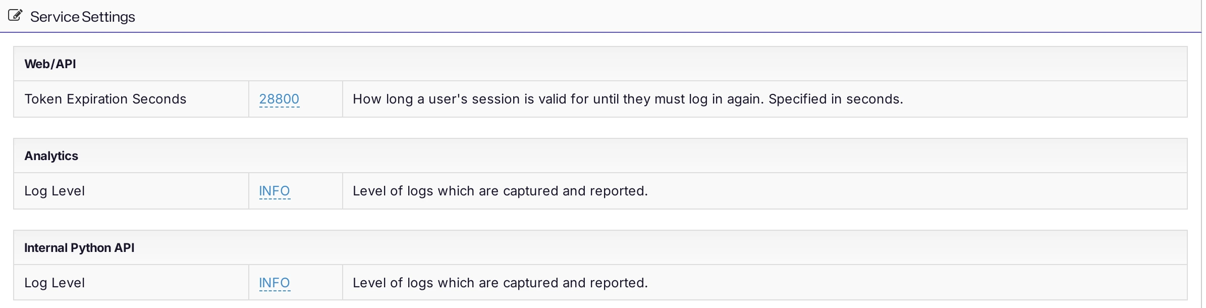

Logging Configuration
Privilege Secure log levels can be set in the UI for each service.
