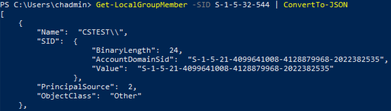

A member of the local Administrators group on the target system has incomplete data. To check, run the following PowerShell command on the system:
Get-LocalGroupMember -SID S-1-5-32-544 | ConvertTo-JSON
In the output, the AccountDomainSid and Name values of the member are incomplete. In the example, the Name value is CONTOSO\, but the complete value must include an account, such as CONTOSO\svc-account. The incomplete member causes the product to receive incomplete data for a member of the local Administrators group.
