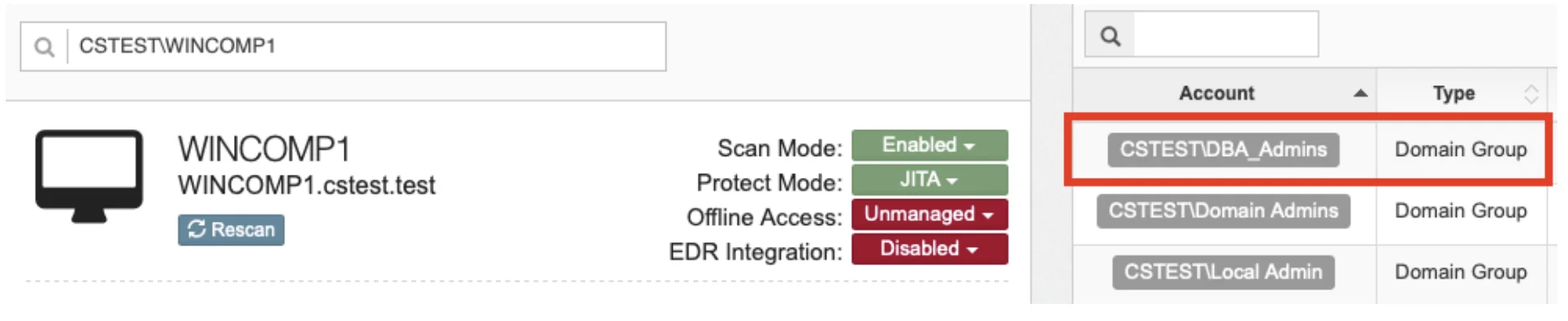

We can update to remove persistence on a single machine through the UI by using the action button to remove persistence.
This only forces the users of the DBA group to go through Privilege Secure on this ONE server. This would leave this group (the DBA administrators) in a mix of using Privilege Secure for some server and not others. It is better to remove persistence for ALL machines that have the DBA_Admins group. This can easily be achieved using Quickstart. Once this is done all the DBA Administrators will go through Privilege Secure for the servers that they need access to. Optionally a review and approval of the users who exist in the targeted group can also be carried out in conjunction with the owner of the group (machines that this group applies to can be shared with group and machine owners as required)

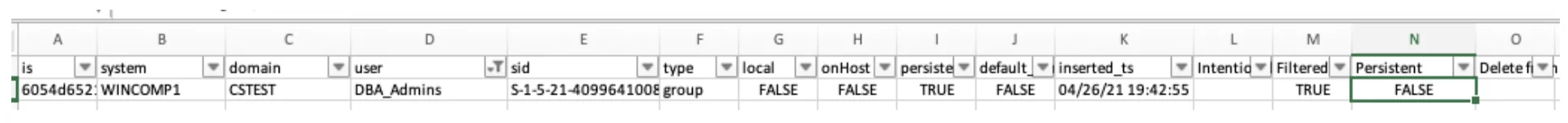

The updates to the Quickstart spreadsheet would be as follows:
Here we have filtered on the DBA_Admins group. We the return the persistence to FALSE. This should be for ALL machines that have DBA_Admins.

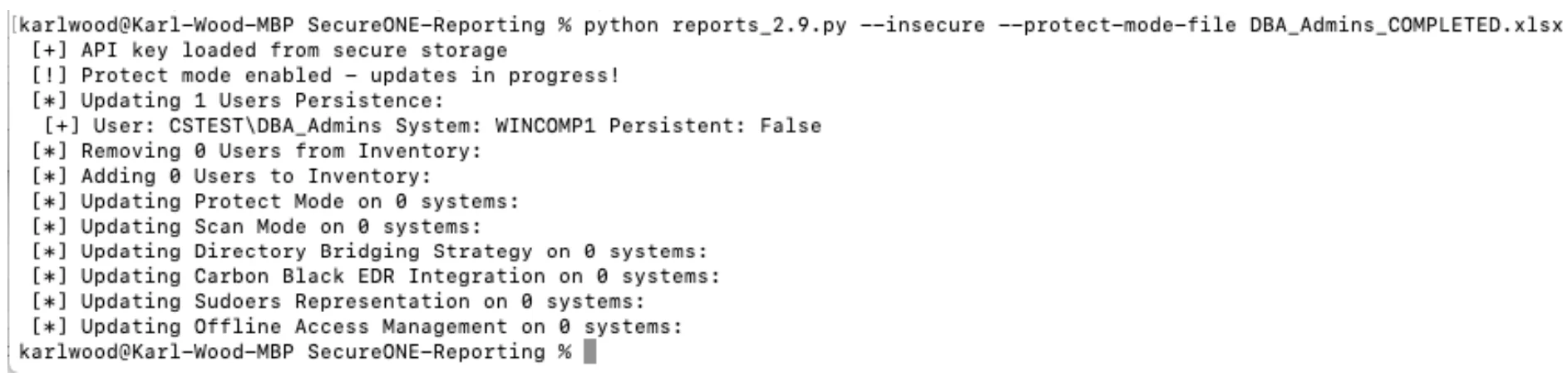

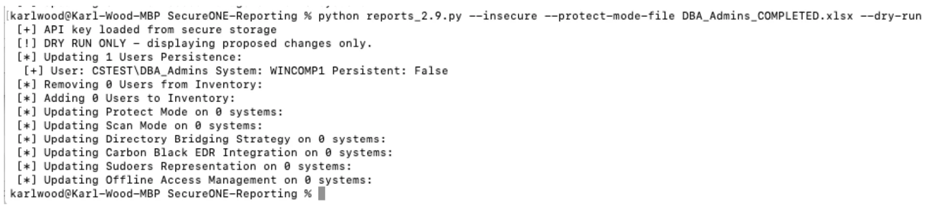

Again store the upload spreadsheet file with a suitable name, in the Privilege Secure reporting folder. Run the command below to apply the change to Privilege Secure (dry run first).
reports_2.9.py --insecure --protect-mode-file DBA_Admins_COMPLETED.xlsx --dry-run

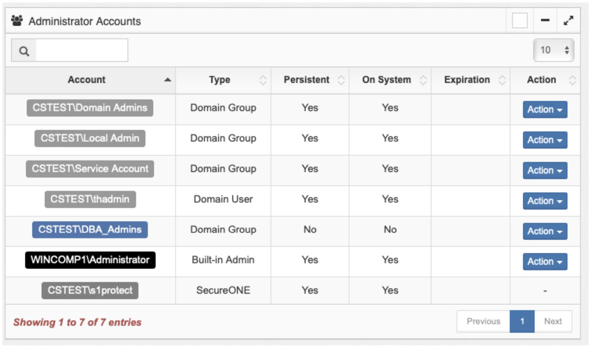

(__Project Management__) Users within the DBA_Admins group should now be informed of the change, along with the training and issue resolution information again. Through the UI we can see the effect on one of the machines, WINCOMP1 in this case.
The DBA_Admins users are now forced to request elevated access through Privilege Secure. This would be the case for ALL machines that the group has access to. In this case it was a single machine.
