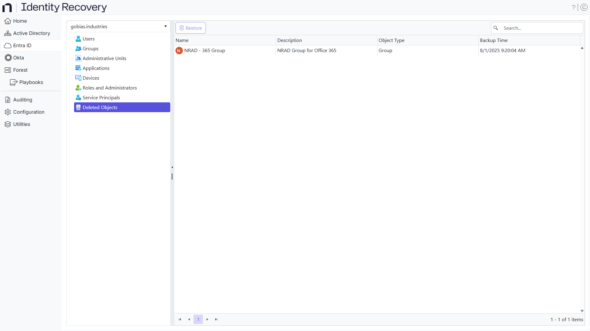

Step 1 – Click Entra ID in the left pane to open the Entra ID Page.
Step 2 – Select and expand a tenant in the left pane and locate the object you want to restore from the Deleted Objects container.

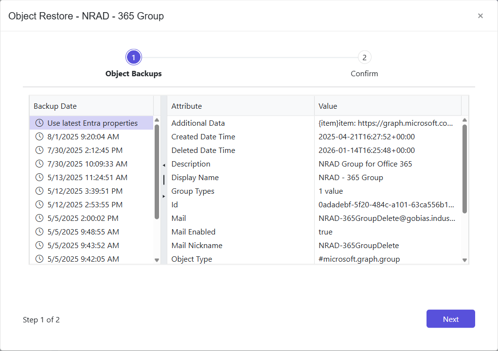

Step 3 – Do one of the following:
  • Select the object to restore and click the Restore button.
  • Right-click the object and select Restore on the shortcut menu.
The Object Restore wizard opens.
Object Restore wizard - Object Backup page

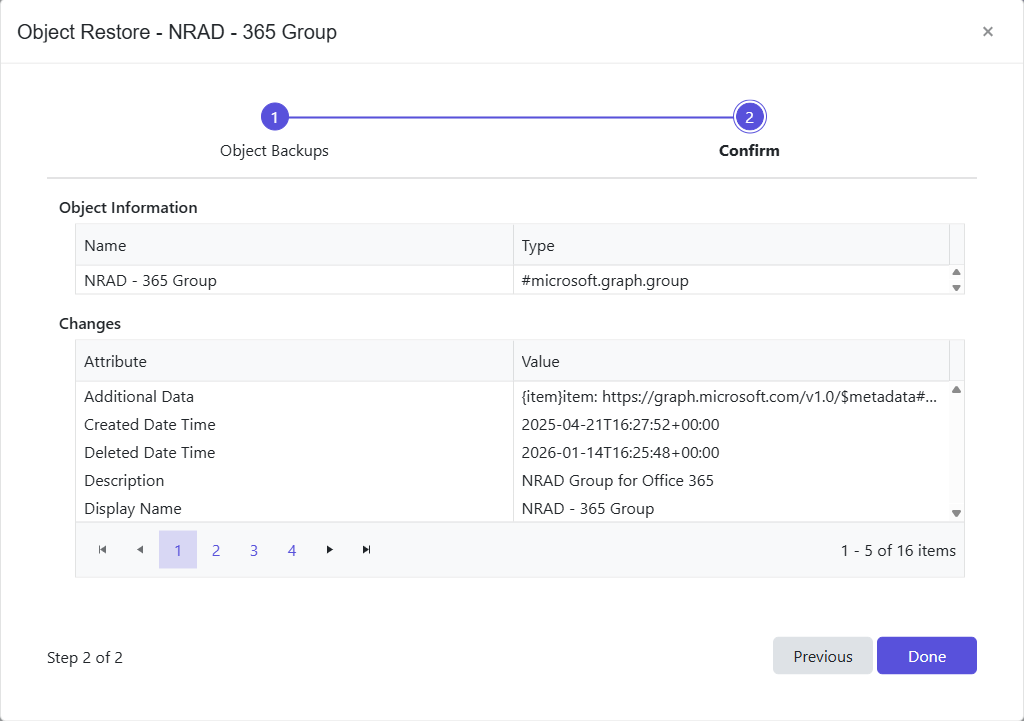

Step 4 – The Confirm page displays a summary of the settings you provided on the pages of the wizard. Use the Back button to return to a previous page and change any setting. Click Done to finish the wizard.
Object Restore wizard - Confirm page

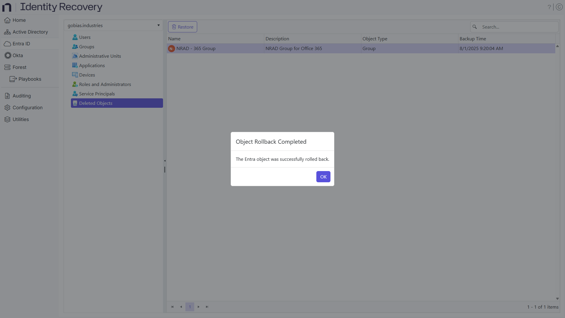

Step 5 – A completed message is displayed when the rollback is successful. Click OK.
Object Restore Sucessful message
The object has been restored.
