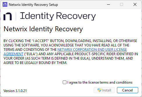

Recovery for Active Directory Setup wizard - Initial EULA page
Step 2 – On the Netwrix Identity Recovery page, read the End User License Agreement. Then check the I agree to the license terms and conditions checkbox and click Install.

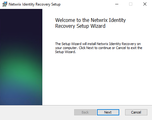

Installation Welcome Page
Step 3 – On the Welcome page of the Identity Recovery Setup wizard, click Next to begin the installation.

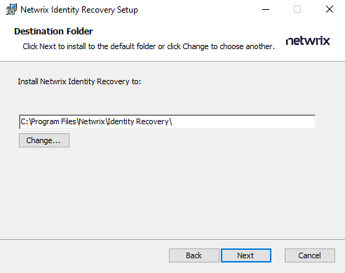

Installation Destination Folder Page
Step 4 – On the Destination Folder page, confirm the destination path where the wizard will install Identity Recovery. The default installation location is:
C:\Program Files\Netwrix\Identity Recovery\

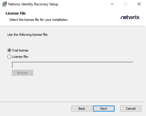

Installation License File Page
Step 5 – On the License File page, select the licensing option for your installation.
  • Trial license – Use the 14-day license key that comes packaged with the Identity Recovery installation
  • License file – Map to a customer license key file by clicking Browse and selecting the license file with the name ending in .key
Click Next.

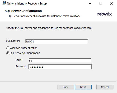

Installation SQL Server Configuration
Step 6 – On the SQL Server Configuration page, specify the SQL server and credentials to use for database communication.
  • SQL Server – Enter the SQL Server fully-qualified DNS location name or IP address of the SQL Server machine.
  • Choose between Windows Authentication or SQL Server Authentication credentials. If SQL Server Authentication is selected, provide the login credentials for the provisioned account. Ensure that this account has access to read and write to the tables with permissions to execute stored procedures.
Windows authentication will use the credentials of the account running the installer. Once the database is created, Windows authentication will use the credentials of the account specified for the Identity Recovery service on the Netwrix Recovery Server Configuration page of the wizard.
Click Next.

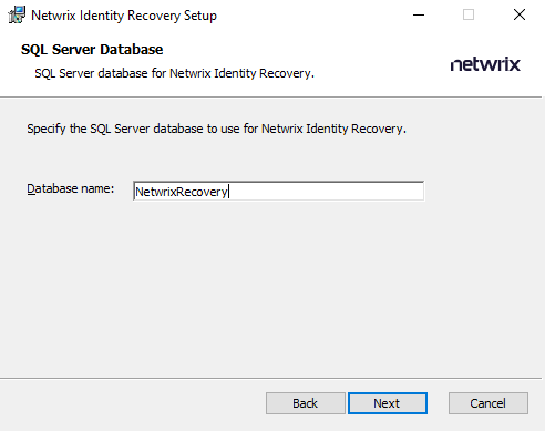

Installation SQL Server Database Name
Step 7 – On the SQL Server Database page, specify the SQL Server database to use. Use the default database name or provide a unique, descriptive name in the box. Click Next to continue.

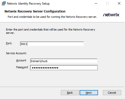

serverconfiguration
Step 8 – On the Netwrix Recovery Server Configuration page, enter the port and credentials to be used for running the application server.
  • Port – The default port number for the Netwrix Recovery server is 9001. This port is used to communicate from the Netwrix Recovery server and the domain. Modify the port, if needed.
  • Service Account – Enter the service account [DOMAIN\USERNAME] and password credentials used to start and run the Recovery Console service. Ensure that this service account has the Log On As A Service right in the Local Security Policies on the server where the console is installed.
Click Next.

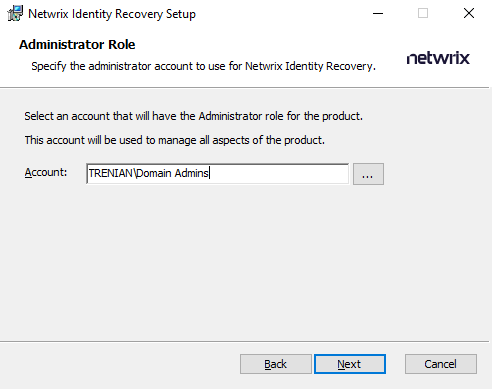

Installation Admin Role Page
Step 9 – On the Administrator Role page, specify the administrator account to use. By default, this is set to the Domain Admins account from the domain the product is being installed into.
  • Account – Enter a user account or group [DOMAIN\ACCOUNT] that will be the default Identity Recovery administrator. Use the Browse option to search for a specific account. This account will be locked and cannot be modified after installation.
    The specified user or group will be responsible for configuring the applcation and managing users' access to the console.
Click Next.

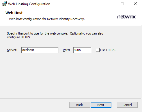

Installation Web Host Configuration
Step 10 – On the Web Host page, specify the web host configuration for the Identity Recovery Console.
  • Port – Use the default port number or provide a unique one.
  • Use HTTPS – To enable HTTPS encryption, select the Use HTTPS checkbox. This displays the Certificate section on the page. Click Select certificate.... The Certificates window is displayed.
Installation Certificates Window
  • The Certificates window displays installed certificates on either the local machine or the current user. Select the desired certificate and click Use Selected Certificate. This automatically fills in the information for the Certificate section of the Web Host page.
Click Next. Identity Recovery is ready to install.

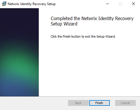

completed
Step 12 – The installation process begins and the Setup wizard displays the installation progress. Depending on the Active Directory size, installation may take time to complete. When installation is complete, click Finish to exit the wizard.
The installer does not automatically open the Recovery Console web page after installation. The Recovery Console icon is located on the desktop. See the First Launch topic for the next step.
