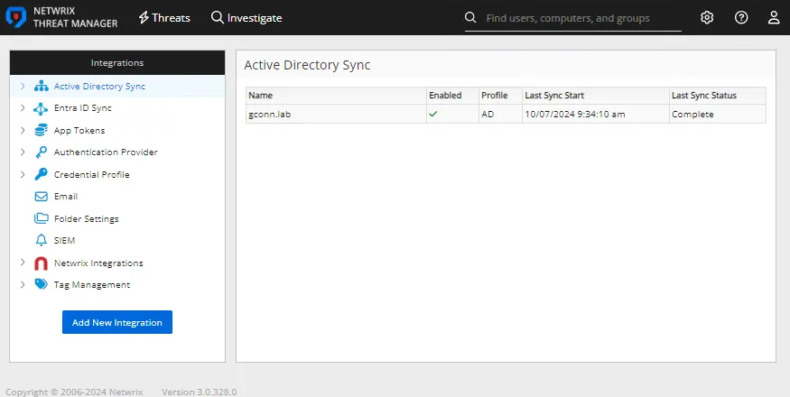

The Active Directory Sync page within the Integrations interface lists the domains that are synced to theThreat Manager database. The sync operation gets all information about an Active Directory environment (users, groups, hosts, etc).See the Permissions for Active Directory Sync  topic for additional information about the permissions required for Active Directory syncing.
Use the gear icon in the upper right corner of the console to open the Configuration menu. Then select Integrations to open the Integrations interface.
Click Active Directory Sync in the navigation pane to view a list of the already added Active Directory domains, if any. Each added domain represents a sync policy.
Integrations interface on the Active Directory Sync page
A service named Active Directory Service continuously runs to collect data for the specified domains. It evaluates the USN value of an object and syncs when the object changes. The table provides the following information:
  • Name – Name of the domain. This may be either the domain DNS name or domain controller hostname.
  • Enabled – icon indicates the enabled state:
    • Checkmark icon – Enabled
    • X icon – Disabled
  • Profile – Name of the Credential Profile assigned to the policy. As mentioned earlier, each added domain represents a sync policy.
  • Last Sync Start – Date timestamp when the task started for the most recent sync
  • Last Sync Status – Event status for the most recent sync task
To view policy details or make modifications, select a domain from the table or under Active Directory Sync in the navigation pane.

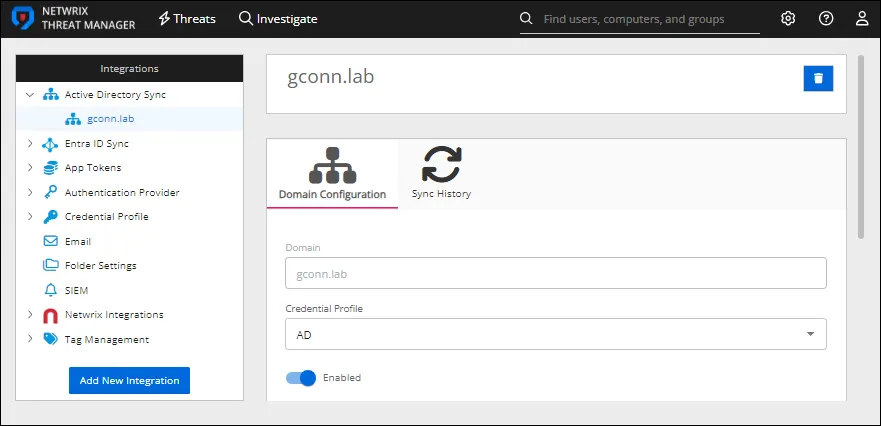

Active Directory Sync details page for a specific domain
Select the domain from the list to see modification options:
  • Name – The box at the top displays the name of the domain
    • Delete – The delete button in the upper right corner of the box opens the Delete Domain window to confirm the action
  • Domain Configuration – Displays the sync policy settings entered for the selected domain. These settings can be modified on this tab. See the Domain Configuration Tab topic for additional information.
  • Sync History – Displays the information on each synchronization event. See the Sync History Tab topic for additional information.

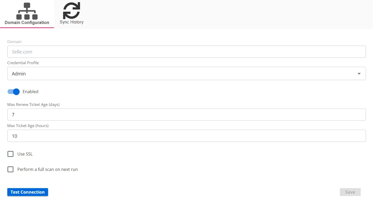

The Domain Configuration tab displays the sync policy settings entered for the selected domain. Except for the domain itself, these settings can be updated as needed.
Active Directory Sync details page for a specific domain showing the Domain Configuration tab
The Domain Configuration tab displays the following settings:
  • Domain – Displays the domain DNS name or domain controller hostname in the required format of [DOMAIN.COM], e.g. NT-DC03.NWXTech.com
  • Credential Profile – Displays the Credential Profile by name
  • Enabled / Disabled – Toggle indicates if the policy is enabled to run the sync service
  • Max Renew Ticket Age (days) – The maximum number of days for the Renew Ticket Age for the domain. This value must match the domain configuration. See the Microsoft Max-Renew-Age attribute article for additional information.
    This value is required to accurately evaluate the Golden Ticket threat.
  • Max Ticket Age (hours) – The maximum number of hours for the Ticket Age for the domain. This value must match the domain configuration. See the Microsoft Max-Ticket-Age attribute article for additional information.
  • Use SSL – Indicates whether you have enabled SSL for secure communication with the domain. See the Microsoft 5.1.1.2 Using SSL/TLS article for additional information.
  • Perform a full scan on next run – Indicates whether the next sync looks only for domain changes or runs a full scan of the domain. By default, this option is enabled for the first sync executed when a new domain is added; however, Threat Manager disables it automatically after the first sync. Use this option to fully refresh domain information, though it is typically not needed for normal operation.
  • Test Connection – Click Test Connection to ensure connection to the domain. A message appears in the upper right corner of the console indicating a successful or failed connection.
The Save button is enabled when any settings are modified. Click it to commit the changes before leaving the page.
