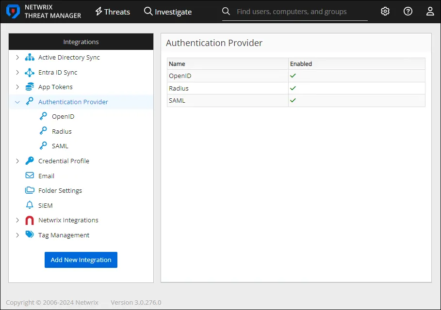

Use the gear icon in the upper right corner of the console to open the Configuration menu. Then select Integrations to open the Integrations interface.
Integrations interface on the Authentication Provider page
Click Authentication Provider in the navigation pane to view a list of already configured authentication providers, if any.
The table displays the provider name, as supplied during configuration, and an icon indicating if the integration is enabled. To view provider details or make modifications, select a provider from the table or select it from the Credential Profile dropdown in the navigation pane.
