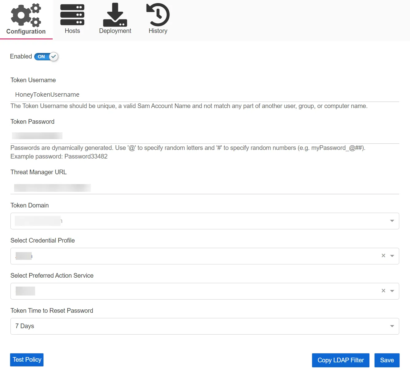

Configuration Tab​
The Configuration tab provides information on the selected policy for a Honeytoken.
configurationtab
The Configuration tab contains the following configuration options:
  • Enabled – This option is set to ON or enabled by default. Click the checkmark to set to OFF or disabled.
  • Token Username – The username used by the Honeytoken deployment process and threat detection. This is a static username used for all deployments for this policy.
    The token username can be changed post-deployment, however Threat Manager no longer detects tokens under the previous username.
    info
    Don't change the username of a Honeytoken after a successful deployment of the token to a host.
  • Token Password – Specify a password string to be used for the Honeytoken deployment. Passwords require at minimum one wildcard character. Use '@' to specify random letters and '#" to specify random numbers.
    If the Honeytoken script can't reach the Threat Manager URL, the Honeytoken still deploys but Threat Manager is unaware of the Honeytoken deployment status.
  • Threat Manager URL – Specify the Threat Manager address to be used by the Honeytoken script to communicate with Threat Manager. Honeytoken hosts must be able to communicate via HTTP REST to this address to report Honeytoken deployment status
  • Token Domain – The domain to be used for the deployed Honeytoken. This can be selected from existing, known domains or a custom domain can be specified.
  • Select Credential Profile – Lists Credential Profiles added on the Integrations Interface. Select a Credential Profile from the dropdown list.
  • Select Preferrred Action Service – Select the Action Service to be used for Honeytoken deployment.
  • Token Time to Reset Password – All Honeytokens for a policy share a common password. This value specifies how frequently Threat Manager generates a new password for the Honeytoken policy. Select a value using the dropdown menu from the following options:
    • 1 Day
    • 7 Days
    • 14 Days
    • 30 Days
    • 90 Days
  • Test Policy Button– Click the Test Policy button to run an LDAP query for the token username specified. This generates an event that an Active Directory monitoring agent detects and sends to Threat Manager. If the event is received by Threat Manager within three minutes, the button displays Test Succeeded.
    If Threat Prevention is used for Active Directory event monitoring, then an LDAP monitoring policy must be enabled and configured to capture LDAP events for Honeytoken users for the test to be successful. See the Netwrix Threat Prevention Documentation for additional information. If Activity Monitor is used for Active Directory event monitoring, then the LDAP Monitor tab in the AD Monitoring Configuration Window must be configured to capture LDAP events for Honeytoken users for the test to be successful. See the Netwrix Activity Monitor Documentation for additional information.
info
Use the Copy LDAP Filter button to ensure that the LDAP Filter Policy string is properly configured to capture LDAP events for the Honeytoken policy.
  • Copy LDAP Filter Button– Click Copy LDAP Filter to copy the exact string required for Activity Monitor or Threat Prevention to configure the LDAP events for this Honeytoken. Paste the copied string into the LDAP filter policy settings for Activity Monitor or Threat Prevention.
    This is a required configuration to detect LDAP-based Honeytoken threats.
Click Save to update the policy settings. Once saved, threats are detected for this Honeytoken user.
