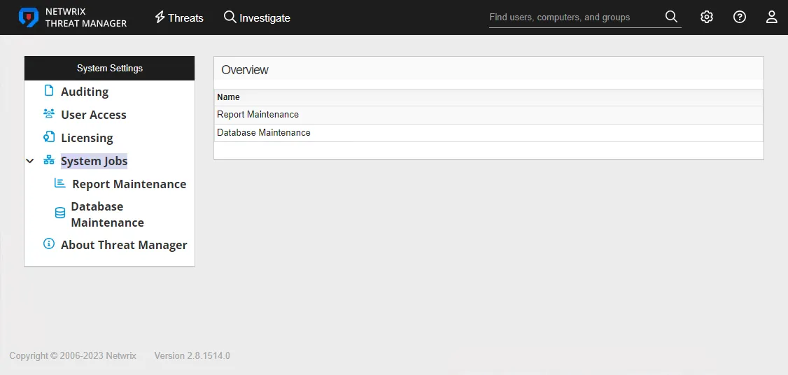

System Jobs Page
The System Jobs page within the System Settings interface contains information and configuration options for the application system jobs.
System Settings interface on the System Jobs page
The table lists the system maintenance jobs:
  • Report Maintenance – Clears old reports
  • Database Maintenance – Clears no longer needed or irrelevant data from the database
The details for a system job can be viewed by selecting it from the table or the navigation pane. The information available varies based on the type of job selected.

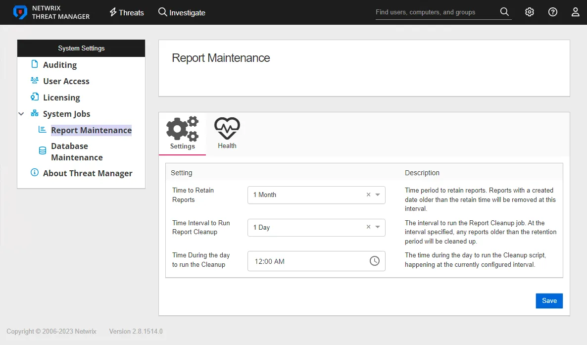

Report Maintenance Job Details Page​
The Report Maintenance job details page has two tabs that provide configuration options and job health details.
System Settings interface on the System Jobs page showing the Report Maintenance job Settings tab
Settings Tab
The Settings tab has the following configurable settings:
  • Time to Retain Reports – Time period to retain reports. Reports with a created date older than the retain time are removed at this interval. By default, this is set to 1 Month. Use the dropdown menu to select another interval, which includes 1 Day, 1 Week, 1 Month, 3 Months, and 6 Months as options.
  • Time Interval to Run Report Cleanup – The interval to run the Report Cleanup job. At the interval specified, Threat Manager removes any reports older than the retention period. By default, this is set to 1 Day. Use the dropdown menu to select another interval, which includes 1 Day, 1 Week, and 1 Month as options.
  • Time During the day to run the Cleanup – The time during the day to run the Cleanup script at the configured interval. By default, this is set to midnight, 12:00 AM. Use the clock menu to select the time you want.
