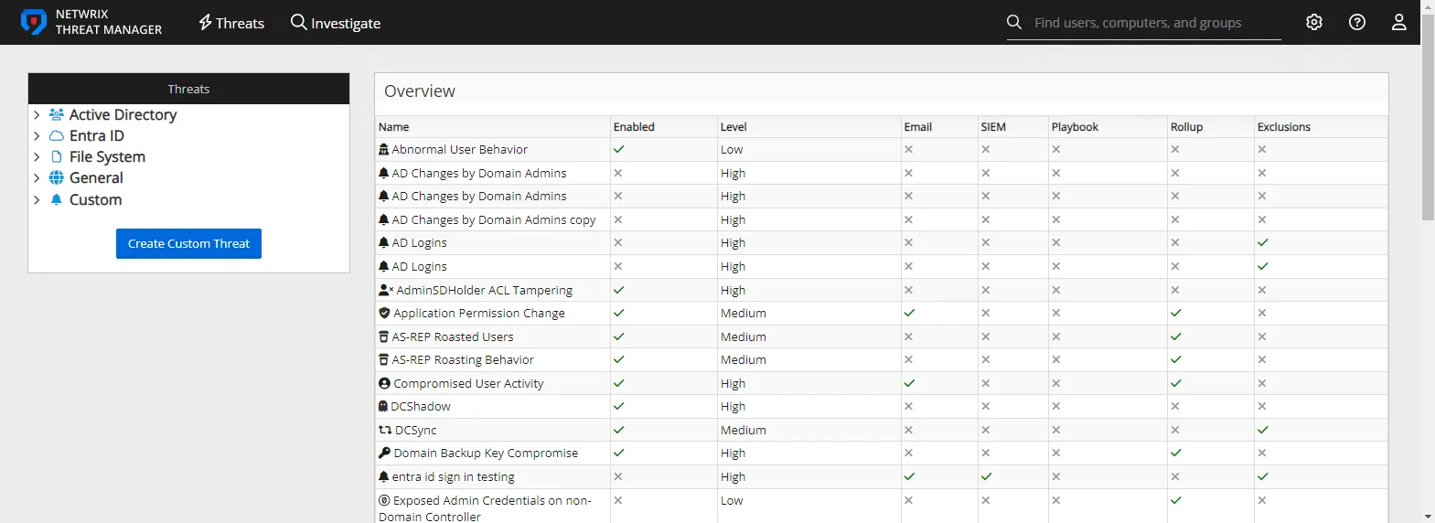

Overview Table​
The Overview table provides a high-level status of all threats. The table includes the following information:
This screenshot displays the Overview table on the Threat Detection page.
  • Name – The threat name
  • Enabled – A green check mark indicates that the threat type is enabled for threat detection. A gray x indicates that the threat type isn't enabled for threat detection.
  • Level – The relative severity level, or risk level, of the threat. See the Fine Tune a Threat topic for additional information.
  • Email – A green check mark indicates that email notifications are sent when the threat is detected. A gray x indicates that email notifications are disabled.
  • SIEM – A green check mark indicates that threat information is sent to a SIEM service when the threat is detected. A gray x indicates that forwarding to a SIEM service is disabled.
  • Playbook – A green check mark indicates that a Playbook is assigned to the threat. This means that Threat Manager automatically runs the playbook every time a threat of this type is detected.
  • Rollup – A green check mark indicates that rollups are enabled. A gray x indicates that rollups aren't enabled. See the Fine Tune a Threat topic for additional information.
  • Exclusions – A green check mark indicates that one or more exclusions are present for this threat type. A gray x indicates that no exclusions are present for this threat. See the Fine Tune a Threat topic for additional information.
