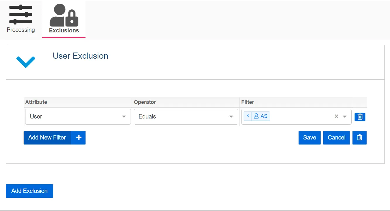

Exclusions Tab​
The Exclusions tab lists existing exclusions for the threat. Exclusions use rule-based definitions to specify criteria that Threat Manager excludes from threat detection for the threat type.
exclusionstab
To view details of an existing exclusion, click the arrow next to the exclusion or the name of the exclusion.
Exclusion Details:
  • Add New Filter – Click the Add New Filter button to include an additional filter rule for the exclusion.
  • Delete Filter – Click the smaller Delete Icon to the right of the filter to delete that filter.
  • Save – Click Save to save changes made to the exclusion.
  • Cancel – Click Cancel to close the exclusion details and disregard any changes made to the exclusion.
  • Delete Exclusion – Click the larger Delete Icon to the right of the Cancel button below the filters to delete the exclusion. A confirmation window appears before the deletion completes.
Click Add Exclusion to Add a new Threat Detection Exclusion.
Add Threat Detection Exclusions​
This screenshot displays the Add Exclusion for Threat Detection window.
Step 1 – Click Add Exclusion. The Add Exclusion for [Threat Type] window opens.
Step 2 – Select a Name for the exclusion
Step 3 – Select an Attribute from the Attribute dropdown list:
  • User
  • Host
  • Client
  • File
Step 4 – Select an Operator from the Operator dropdown list.
Step 5 – Select a Filter by searching for the value and selecting it from the dropdown list. Or, manually enter the value for the selected exclusion type in the following format:
  • Computer – [domain][hostname]
  • Client – [domain][hostname]
  • User – [domain][username]
  • File – Folder path and full path to file. This exclusion also supports the asterisk wildcard: *
Step 6 – (Optional) Click Add New Filter to include an additional filter rule for the exclusion.
Step 7 – Click Saveto save the exclusion details. Click Cancel to close the modal and disregard any changes made to the exclusion.
The exclusion is added to the Exclusions list and the specified activity is immediately excluded from threat detection for the threat type.
