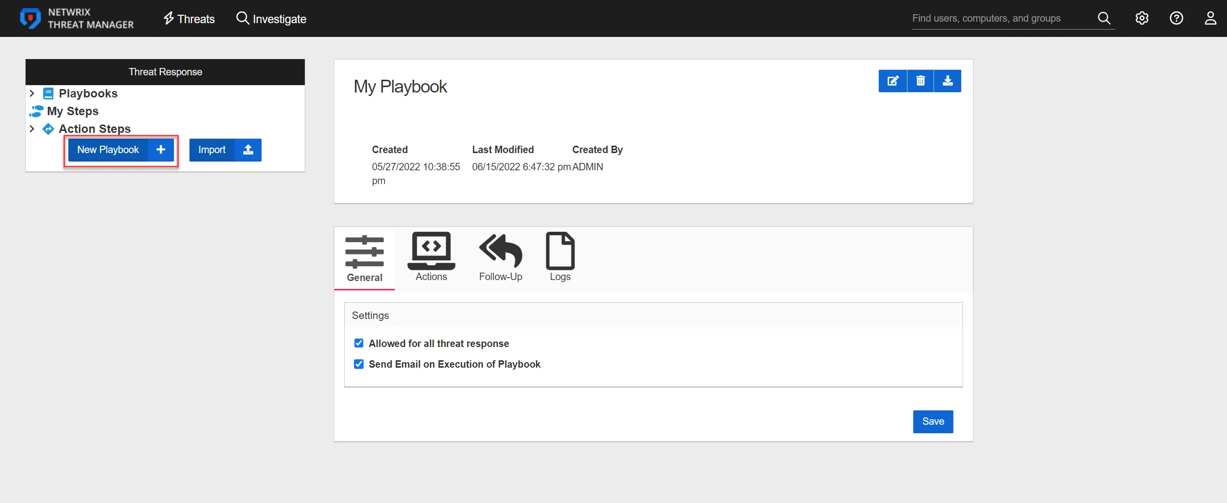

Step 1 – In the Threat Response box, click New Playbook. A new playbook called "My Playbook 1" is created. As additional Playbooks are added, sequential numbers are appended to My Playbook.
Change the name of the playbook immediately after creation for organizational purposes.
Step 2 – Select the newly-created playbook from the Playbooks tab and click the Edit button. Rename My Playbook with the name you want and optionally enter a description for the playbook in the Description field.
Step 3 – Configure the Playbook using the configuration tabs.
Step 4 – Click the Save button.
The new playbook now has the name you want and steps can be added to the playbook. See the Actions Tab topic for additional information.

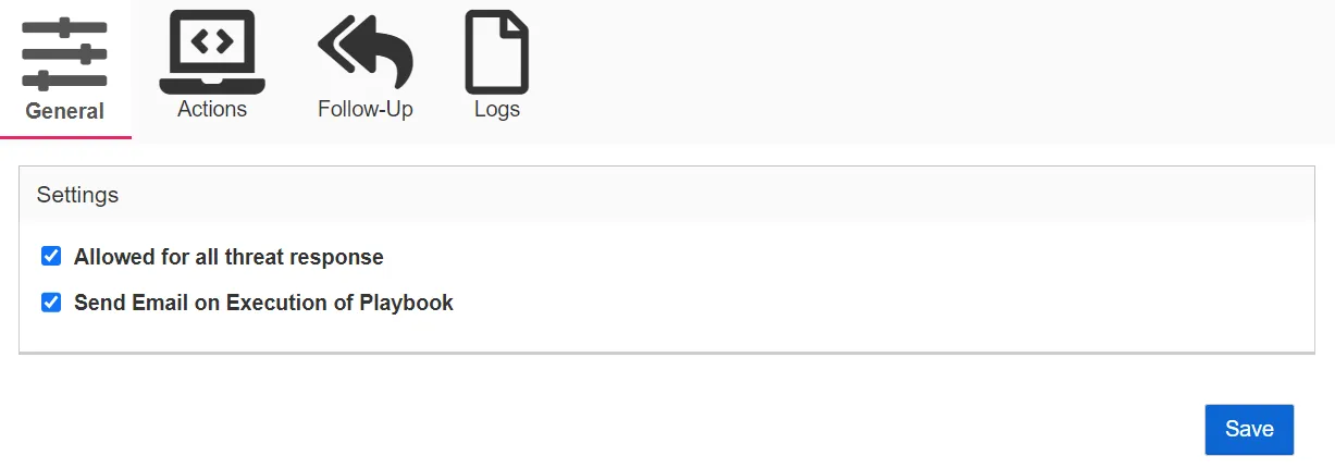

The General Tab contains the Allowed Threats box which allows customization of which threats are applicable for the selected playbook.
generaltab
The General tab has the following configuration options:
  • Allowed for all threat response – Allows customization of which threats are applicable for this playbook. (All threats are allowed by default). If a threat is excluded from Allowed Threats, it isn't available to run ad hoc on the Threat Details page or for automated threat response.
  • Send Email on Execution of Playbook – Threat Manager sends an email notification after the playbook runs.
  • Search Threats – Select the threats that are allowed to be used as a threat response for this playbook from the dropdown list.

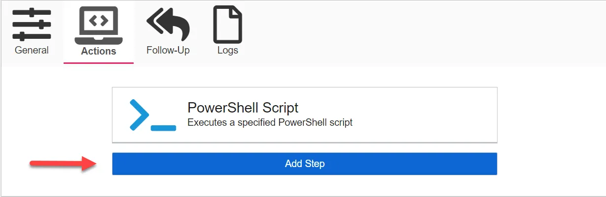

Step 1 – Select the playbook from the Playbooks list in the Threat Response box or on the Playbooks overview.
Step 2 – Click the Actions tab and then click Add Step to open a box to add a step to the playbook.
Step 3 – Enter the following information in the box:
addstep
  • Display Name – The name you want for the step
  • Action Type – The type of action to take for the threat response. Select the action you want from the dropdown list. Additional configuration information is required depending upon the type of action selected. See the Action Configuration for Playbook Steps topic for additional information.
  • Continue on Error – Select this checkbox to execute the next step if the current step fails
Step 4 – Click Add to add the step to the playbook.
The step is added to the playbook.

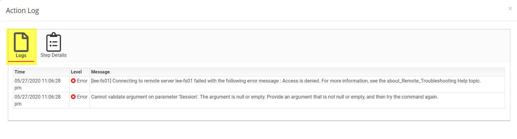

Action Log Window​
The Action Log window contains a Logs tab and a Step Details tab.
Logs Tab​
The Logs tab displays logs for the playbook execution.
This screenshot displays the Logs tab on the Action Log window.
The Logs tab displays a table with the following columns:
  • Time – The timestamp for the log
  • Level – Type of log message displayed, which indicates the severity of the log message
  • Message – Informational text displayed for the log
