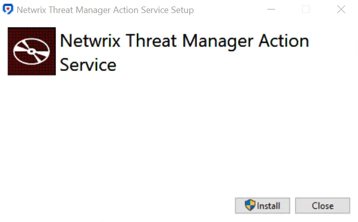

Step 1 – Run the StealthDEFEND.ActionService MSI installation package. The Threat Manager Action Service Setup wizard opens.
settupprogress
Step 2 – Click Install to begin the installation. The setup wizard displays installation progress.

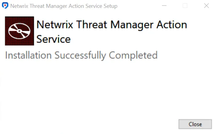

Step 3 – When the installation is complete, click Close to exit the installer.
The Threat Manager action service is now installed on a remote server.
