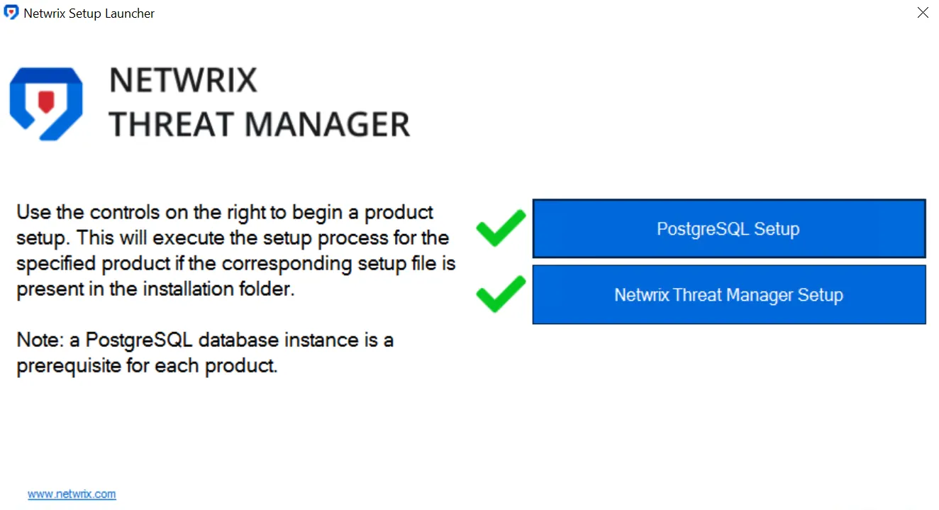

These steps assume you have launched the installer through the Netwrix Setup Launcher (Netwrix_Setup.exe). If you aren't using it, right-click NetwrixThreatManager.exe and select Run as administrator. Then skip to Step 2.
Netwrix Setup Launcher showing PostgreSQL Setup completed

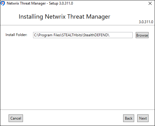

Netwrix Threat Manager Setup wizard Install Folder page
Step 4 – By default, the installation directory is set to:
  • Install Folder – C:\Program Files\STEALTHbits\StealthDEFEND
Optionally, enter a new path or use the Browse button to modify as desired. Click Next.

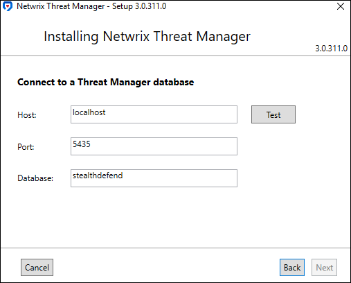

Netwrix Threat Manager Setup wizard Connect to the Database page
Step 5 – On the Database page, ensure the host and port are set correctly. If installing on the same server where the PostgreSQL database application was installed, this information is accurate by default. The default database name is stealthdefend; however, it can be modified as desired. Click Test to validate the connection information.
For example, if you change the default database name from stealthdefend to threatmanager and click Test.
Warning message that the database doesn't exist, Create?
Step 6 – If a successful connection is made, a message window displays confirming the database doesn't exist and you want to create it. Click OK and the window closes.
Step 7 – A "Ready for installation" message appears on the Database page of the wizard and the Next button is enabled. Click Next.
If PostgreSQL is installed on a different host, then the connection details should be updated accordingly.

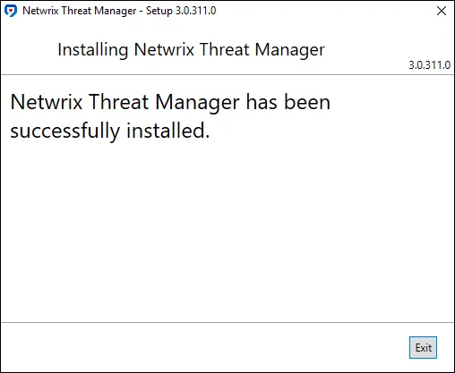

Netwrix Threat Manager Setup wizard Completed Successfully page
Step 9 – The installation process begins and the Setup wizard displays the progress. Click Exit when the installation completes successfully. The Netwrix Threat Manager Setup wizard closes.
Netwrix Setup Launcher with Threat Manager Setup check
Step 10 – Now that both components have been installed, close the Netwrix Setup Launcher.
