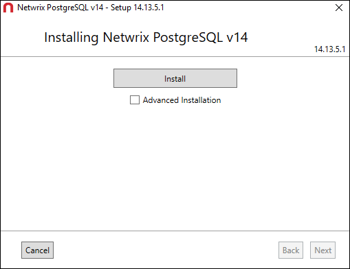

Step 1 – Click PostgreSQL Setup. The Netwrix PostgreSQL Setup wizard opens.
Step 2 – Click Install.
