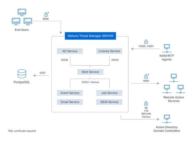

Netwrix Threat Manager architecture and components interactions are shown in the figure below.
Configure appropriate firewall rules to allow these connections.

The following firewall settings are required for communication between the Threat Manager server and applications that provide the data stream:
Communication Direction | Protocol | Ports | Description |
Inbound | UDP | 10000 | Syslog messaging File System event data stream from Activity Monitor agent host(s) |
Inbound | TCP | 10001 | AMPQ Active Directory event data stream from Activity Monitor agent host(s) Active Directory event data stream from Threat Prevention agent host(s) File System event data stream from Threat Prevention agent host(s) |
Bidirectional | TCP | 8080 | Access Analyzer Console Host(s) |

The following firewall settings are required for communication for the Threat Manager services:
Bidirectional | TCP | 55555 | Active Directory login to the application console |
Bidirectional | TCP | 55556 | Active Directory login to the application console |
Bidirectional | TCP | 55557 | Local host communication from the Event Service to the Job Service agent host(s) |
Bidirectional | TCP | Dynamically Configured on Startup | Local host communication from the Event Service to the Job Service agent host(s) |

The following firewall settings are required for communication between the Threat Manager server and the database server, when it is installed on a separate server:
NOTE: These firewall rules are only needed if using a remote PostgreSQL database. That is not recommended or the default.
Outbound | TCP | 5432 | Local Host and Remote communication from the PostgreSQL to the Threat Manager server. |

The following firewall settings are required for accessing the Threat Manager console:
Bidirectional | TCP | 8080 | Remote access to the application console |

The following firewall settings are required for communication between the Threat Manager server and Active Directory domain controllers:
Outbound | TCP | 88 | Kerberos-sec |
Outbound | TCP | 135 | The endpoint mapper tells the client which randomly assigned port a service (FRS, AD replication, MAPI, etc.) is listening on |
Outbound | TCP | 389 | LDAP |
Outbound | TCP | 636 | SSL LDAP |
Outbound | TCP | Various | The port that 135 reports. Used to bulk translate AD object names between formats.(Ephemeral Ports) |

The following firewall settings are required for communication between the Threat Manager server and the remote Action Service server, when it is installed on additional server(s):
Outbound | TCP | 8080 | Remote access to the Action Service server |
