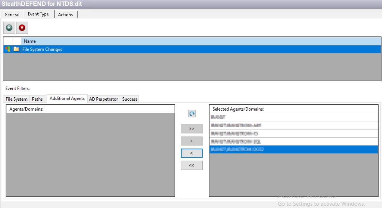

To verify this setting, review the AD Agent column in the interface:
Enable or disable this setting using the Agent Update Settings option. Navigate to: https://docs.netwrix.com/docs/threatprevention/7_5 (Set Options Window).
Access the settings via the following path: Netwrix Threat Manager v7.3 > Administration > Policy Center > Agents Interface > Agents Interface Right-Click Menu > Update Agent Settings. For details, see: https://docs.netwrix.com/docs/threatprevention/7_5 (Update Agent Settings).
