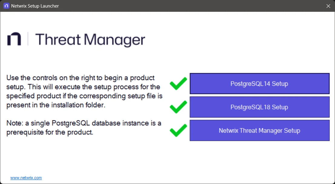

Netwrix_Setup.exe
This executable starts a setup launcher containing buttons to install the PostgreSQL database and the application. The launcher installs these components on the same server. See the installation details for each component in the following sections.

Installation Process
To install the Threat Manager application on a single server:
The PostgreSQL 14 button is only displayed if PostgreSQL 14 is already installed on the host. PostgreSQL 18 is the recommended version for new installs.
Step 1 – Right-click Netwrix_Setup.exe and select Run as administrator. The Netwrix Setup
launcher opens. You can now install the following components on the same server:
- Click PostgreSQL Setup to install the database. See the Install the PostgreSQL Database Application topic for additional information.
- Run the Threat Manager Setup to install the application. See the Install the Threat Manager Application topic for additional information.
