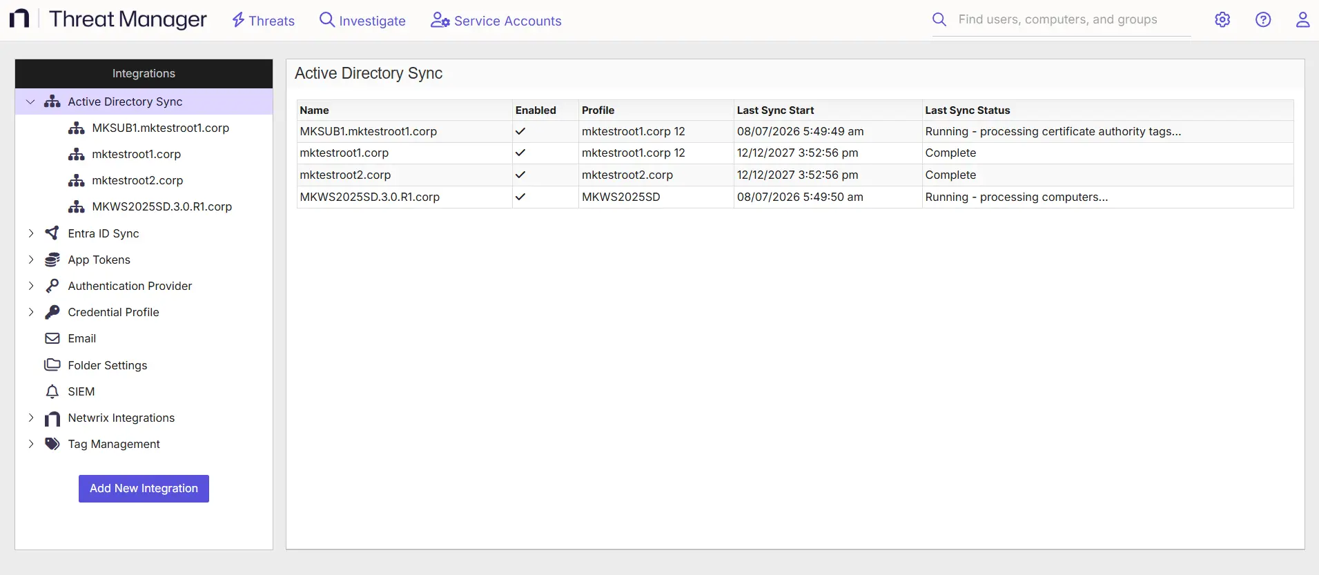

The Active Directory Sync page within the Integrations interface lists the Active Directory domains synced to the Threat Manager database. The sync operation gets all information about an Active Directory environment (users, groups, hosts, etc). See the Permissions for Active Directory Sync  topic for additional information about the permissions required for Active Directory syncing.
Use the gear icon in the upper right corner of the console to open the Configuration menu. Then select Integrations to open the Integrations interface.
Click Active Directory Sync in the navigation pane to view a list of the already added Active Directory domains, if any. Each added domain represents a sync policy.
Integrations interface on the Active Directory Sync page
A service named Active Directory Service continuously runs to collect data for the specified domains. It evaluates the Update Sequence Number (USN) of an object and syncs when the object changes. The table provides the following information:
  • Name – Name of the domain. This may be either the domain DNS name or domain controller hostname.
  • Enabled – icon indicates the enabled state:
    • Checkmark icon – Enabled
    • X icon – Disabled
  • Profile – Name of the Credential Profile assigned to the policy. As mentioned earlier, each added domain represents a sync policy.
  • Last Sync Start – Date timestamp when the task started for the most recent sync
  • Last Sync Status – Event status for the most recent sync task
To view policy details or make modifications, select a domain from the table or under Active Directory Sync in the navigation pane.

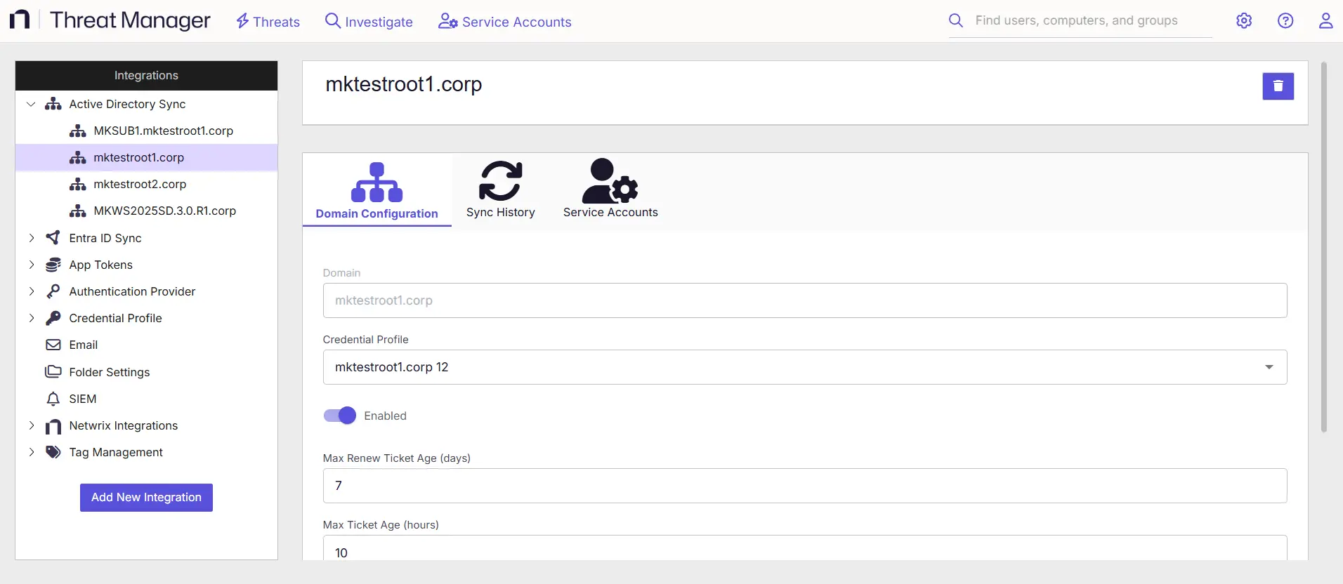

Active Directory Sync Policy Details​
To view the details of an Active Directory sync policy:
Step 7 – Use the gear icon in the upper right corner of the console to open the Configuration menu. Then select Integrations to open the Integrations interface.
Step 8 – On the Integrations interface, click Active Directory Sync in the navigation pane to view a list of the already created Active Directory Sync policies, if any. A policy is represented by the domain for which it is created.
Step 9 – Select a domain from the table or the navigation pane to view the details of the Active Directory Sync policy created for that domain.
Active Directory Sync details page for a specific domain
Select the domain from the list to see modification options:
  • Name – The box at the top displays the name of the domain
    • Delete – The delete button in the upper right corner of the box opens the Delete Domain window to confirm the action
  • Domain Configuration – Displays the sync policy settings entered for the selected domain. These settings can be modified on this tab. See the Domain Configuration Tab topic for additional information.
  • Sync History – Displays the information on each synchronization event. See the Sync History Tab topic for additional information.
  • Service Accounts – Displays rules that tag standard user accounts as service accounts based on Organizational Unit or SAM Account Name. See the Service Accounts Tab topic for additional information.

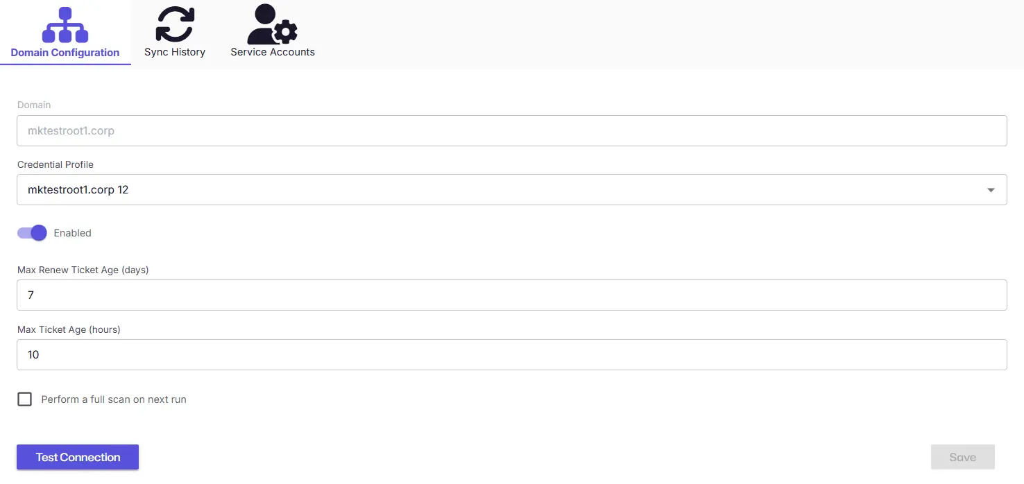

Domain Configuration Tab​
The Domain Configuration tab displays the sync policy settings entered for the selected domain. With the exception of the domain itself, these settings can be updated as needed.
Active Directory Sync details page for a specific domain showing the Domain Configuration tab
The Domain Configuration tab displays the following settings:
  • Domain – Displays the domain DNS name or domain controller hostname in the required format of [DOMAIN.COM], e.g. NT-DC03.NWXTech.com
  • Credential Profile – Displays the Credential Profile by name
  • Enabled / Disabled – Toggle indicates if the policy is enabled to run the sync service
  • Max Renew Ticket Age (days) – Displays the value indicates the maximum number of days of the Renew Ticket Age for the domain. This value must match the domain configuration. See the Microsoft Max-Renew-Age attribute article for additional information.
    This value is required to accurately evaluate the Golden Ticket threat.
  • Max Ticket Age (hours) – Displays the value indicates the maximum number of hours of the Ticket Age for the domain. This value must match the domain configuration. See the Microsoft Max-Ticket-Age attribute article for additional information.
  • Use SSL – Indicates whether you have enabled SSL for secure communication with the domain. See the Microsoft 5.1.1.2 Using SSL/TLS article for additional information.
  • Perform a full scan on next run – Indicates whether the next sync will only look for domain changes or run a full scan of the domain. By default, this option is enabled for the first sync executed when a new domain is added; however, the system disables it automatically after the first sync. Use this option to fully refresh domain information; it isn't typically needed for normal operation.
  • Test Connection – Click Test Connection to ensure connection to the domain. This will take a moment. Then a message will appear in the upper right corner of the console indicating a successful or failed connection.
The Save button activates when you modify any settings. Click it to commit the changes before leaving the page.

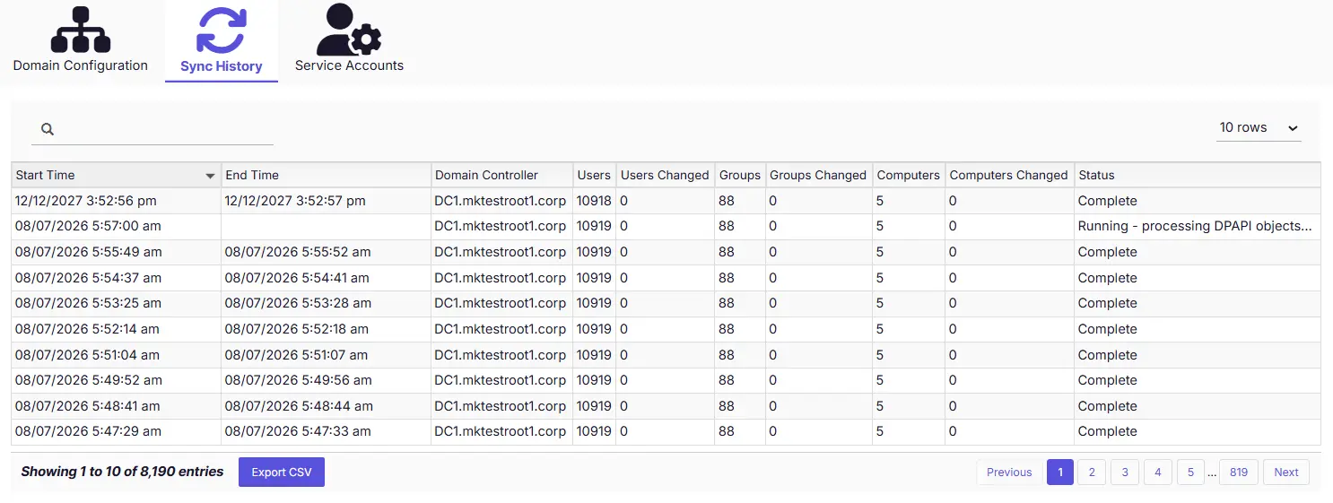

Sync History Tab​
The Sync History tab displays the information on each synchronization event. This includes general information about user, group, and computer objects within the selected domain.
Active Directory Sync details page for a specific domain showing the Sync History tab
  • Start Time – Date timestamp when the task started
  • End Time – Date timestamp when the task completed
  • Users – Number of user objects in the domain
  • Users Changed – Number of user objects with changes detected since the last sync
  • Groups – Number of group objects in the domain
  • Groups Changed – Number of group objects with changes detected since the last sync
  • Computers – Number of computer objects in the domain
  • Computers Changed – Number of computer objects with changes detected since the last sync
  • Status – Event status for the sync task
By default, the table displays 10 records at a time. However, you can set this to 50, 100, or 1,000 rows with the dropdown menu above the right corner of the table. There is a search box above the left corner of the table. Page navigation buttons are below the table. You can also export the data from the current page using the Export CSV button.

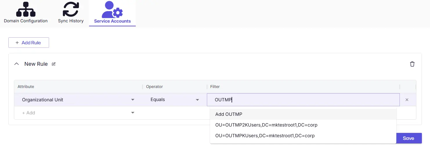

Service Accounts Tab​
The Service Accounts tab lets you define rules that tag standard user accounts as service accounts based on their Organizational Unit (OU) or SAM Account Name. Use this tab to close the classification gap for accounts that Netwrix Threat Manager can't already identify through Active Directory object type — Managed Service Account (MSA), group Managed Service Account (gMSA), or Delegated Managed Service Account (DMSA) — or through User and Entity Behavior Analytics (UEBA) behavioral classification. For example, if your organization houses service accounts in a dedicated OU or names them with a consistent prefix such as SVC_, you can define a rule that tags every matching account without provisioning each one as a managed service account.
Accounts tagged as service accounts, whether tagged by a rule on this tab or by another classification method, appear on the Service Accounts dashboard.
Active Directory Sync details page for a specific domain showing the Service Accounts tab
To add a service account rule:
Step 1 – Click Add Rule. A new rule card opens.
Step 2 – For Attribute, select Organizational Unit or SAM Account Name.
Step 3 – For Operator, select Equals, Not Equal To, Contains, Does Not Contain, Starts With, or Ends With.
Step 4 – For Value, enter or select the value to match.
  • If Attribute is set to Organizational Unit, start typing to see autocomplete suggestions of OUs that exist in the domain. Select Add OU to enter an OU that isn't in the list.
  • If Attribute is set to SAM Account Name, start typing to see autocomplete suggestions of account names that exist in the domain, or enter a value directly. For example, select the Starts With operator and enter SVC_ to match every account name that begins with SVC_.
Step 5 – To add another condition to the rule, click + Add and select an attribute.
Step 6 – Click Save. Netwrix Threat Manager tags matching accounts as service accounts on the next Active Directory sync.
Repeat this process to add additional rules. Click Add Rule to create another rule, or select an existing rule to expand, edit, or delete it.
Removing a rule or a condition doesn't untag accounts that are already tagged as service accounts. To remove the Service Account tag from an account manually, use the Tag Management page.
