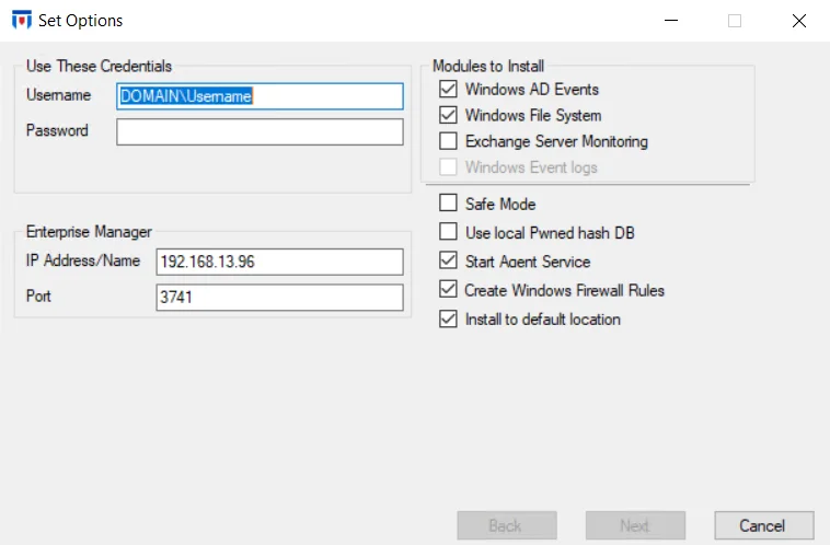

Step 4 – On the Set Options window, enter the credentials required to deploy the Agent on the selected machine(s). Review the Enterprise Manager IP address/name and port for accuracy and select the desired modules to install for this Agent. You can also set other properties for the Agent. See the Set Options Window topic for additional information.
Step 5 – Once configurations are set, click Next.

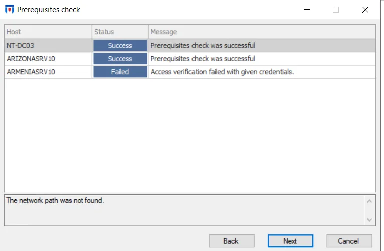

Step 6 – On the Prerequisites Check window, the credentials provided on the Set Options window either succeed or fail during a prerequisites or verification check. It also initiates a prerequisite check for the Agent. See the Prerequisites Check Window topic for additional information.

Step 4 – On the Set Options window, ensure the proper credentials, modules, and Enterprise Manager location are accurate alongside additional options. To make changes to the settings, uncheck the Keep Existing Settings box. Make necessary updates as needed. See the Set Options Window topic for additional information.
Step 5 – On the Prerequisites Check window, the credentials provided on the Set Options window either succeed or fail during a prerequisites or verification check. See the Prerequisites Check Window topic for additional information. Click Next.
