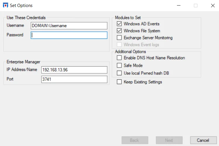

Set Options Window for Update Agent Settings
On the Agents interface, when you open the Set Options window through the Update Agent Settings option on the Right-Click Menu, the window appears as follows:
This window displays the default selections in the Modules to Set and Additional Options areas; they do not represent the actual current state of the Agent.
To view the current state and configured options for an Agent, hover over the Version String column on the Agents Interface data grid for the tool tip. The AD Agent column indicates the Agent’s mode.
This Set Options window is the same as discussed above, with the exception of the following:
Enable DNS Host Name Resolution – See the DNS Host Name Resolution topic for information. Even when this option is enabled for the Agent, it is displayed as unchecked. You must either check this setting or check the Keep Existing Settings checkbox to keep it enabled for the Agent.
Keep Existing Settings – When checked, options in the Modules to Set and Additional Options areas are grayed out and cannot be changed, indicating that the same current settings are retained for the Agent.
This setting has no impact on the Use These Credentials and Enterprise Manager areas.
Make sure you select the desired settings for the Agent on this window, such as the Enable DNS Host Name Resolution and Safe Mode options, even when they are currently enabled for the Agent. Leaving them unchecked will disable those settings when the wizard completes.
