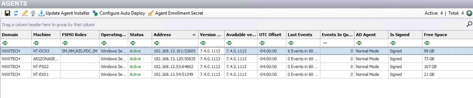

Click Agents in the left pane to open the Agents interface.
Agents Data Grid
The Agents data grid displays information on each domain where an Agent is deployed.
The upper-right corner of the data grid displays the Agent tally, indicating the number of active Agents as well as the total number of deployed Agents. The data grid displays the following information for an Agent:
Domain – Targeted Active Directory domain
Machine – Server where the Agent is deployed. Hover over data in this column to view the following date/time stamps:
Last Agent to Manager Communication – Last change event sent from the Agent to the Enterprise Manager
Last Agent Heartbeat – Last time the Enterprise Manager received a heartbeat from the Agent
AD Event Latency – Time difference between when the event was detected by the Agent and when the Enterprise Manager received it
noteWhen the Send Latency Alerts option is enabled in the Event Filtering Configuration Window, a warning symbol appears to indicate excessive latency. This warning symbol also appears when the Agent fails to load the instrumentation DLL into the LSASS process or when it fails to load the instrumentation DLL to MS Exchange.
FSMO Roles – The FSMO (Flexible Single Master Operation) role(s) currently assigned to the domain controller where the Agent is deployed. Role names are displayed as abbreviations. For example, 'SM' is displayed for the Schema Master role. Hover over data in this column to view the full names.
noteYou can use the FSMO roles information in combination with a policy created for the FSMO Role Monitoring Event Type to view events about which machine acquired a FSMO role and which machine relinquished it.
Operating System – Operating system for the machine where the Agent is deployed with version information, including service pack details. For example, Windows Server 2022 Standard.. For example, Windows Server 2019 Standard

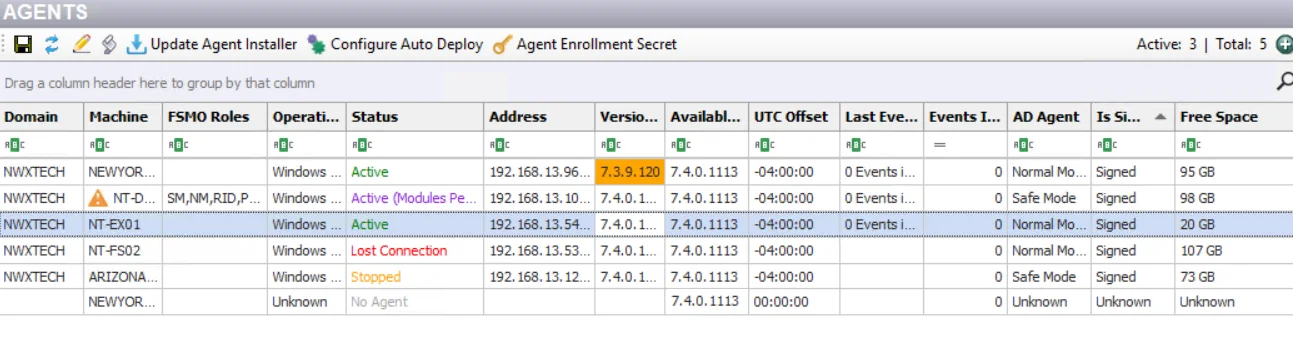

Status – the Agent’s current status:
- Active (green) – The Agent is actively monitoring/blocking events and communicating with the Enterprise Manager
- Active (Modules Pending) – The Agent is active, but the Windows AD Events module has not been loaded due to Safe Mode. See the Agent Safe Mode topic for additional information.
- Stopped (orange) – The Agent has been stopped and is not monitoring/blocking events
- Lost Connection (red) – The Agent is not actively communicating with the Enterprise Manager
- No Agent (gray) – a domain controller has been found within the targeted domain where the Agent is not yet deployed
Address – IP address of the server where the Agent is deployed. Hover over data in this column to view the IP address with port
Version String – Agent build version
- If the Agent’s version is older than the current version available in the Administration Console, it is highlighted. This indicates that an upgrade is recommended.
- Hover over data in this column to view a listing of the Agent’s configured settings. This information includes information on modules that are running and those that are pending (for Safe Mode).
UTC Offset – Local server time zone relationship to the Universal Time (UTC)
Last Events – Number of events reported by the Agent in the last notification to the Enterprise Manager
Events In Queue – Count of events the Agent is waiting to send to the Enterprise Manager
AD Agent – Indicates if the Agent is running in Normal Mode or Safe Mode
Is Signed – Indicates if the Agent is signed or unsigned
Free Space – Amount of free space on the drive the Agent is installed on
Agent Last Stopped – Date timestamp for when the Agent was last stopped
Build Time Stamp – Date timestamp for when the Agent version was created
Certificate Thumbprint – The certificate used by the Agent to communicate with Enterprise Manager
Features – Features available for the Agent and its configured modules
FQDN – Fully-qualified domain name of the machine where the Agent is deployed
Last Registration – The date and time when the Agent successfully connected to the Enterprise Manager (became Active)
Modules – Event sources loaded and running on the Agent
Platform – Operating system platform for the machine where the Agent is deployed, for example, Windows
This data grid employs features for sorting, filtering, searching, and more. See the Data Grid Functionality topic for additional information.
