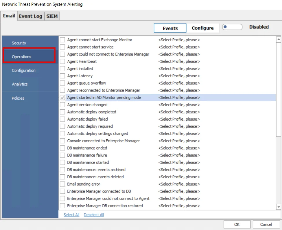

Step 1 – Clck Configuration > Alerts on the menu. The Netwrix Threat Prevention System Alerting window opens.
Step 2 – On the Email tab, click Configure.
Step 3 – Create a message profile for the Safe Mode notification with the recipient(s) to be notified when the AD modules are pending. See the Create Message Profiles topic for additional information.
Step 4 – Select Events, and then Operations on the left. Check the Agent Started in AD Monitor pending mode event alert and select the message profile you created in Step 3 from the drop-down menu to assign it to the alert. See the Email Tab topic for additional information.
Step 5 – Ensure that the email alerts are Enabled and click OK.
When the Agent Started in AD Monitor pending mode event alert is triggered, an email notification is sent to the recipient(s) in the selected message profile.
