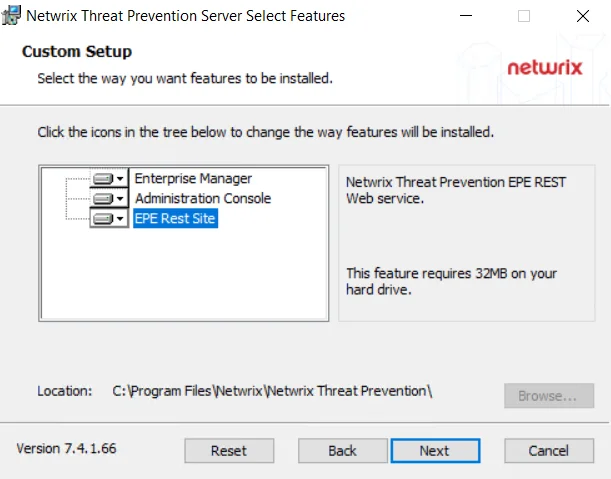

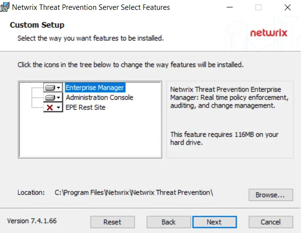

Step 4 – The Custom Setup page displays the components that are installed by default. These components require the following hard drive space for installation:
- Enterprise Manager – 116 MB
- Administration Console – 145 MB
- EPE Rest Site – 32 MB
Optionally, you can change the installation directory location for Threat Prevention.

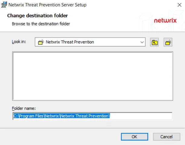

(Optional) Click Browse… to change the installation location. The Change destination folder page opens.
- Use the Look in field to select the desired installation folder.
- When the Folder name box is set as desired, click OK.
The wizard returns to the Custom Setup page. You can use the Reset button to revert to the default settings on the Custom Setup page. Click Next to proceed.

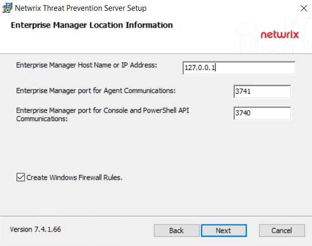

Step 6 – On the Enterprise Manager Location Information page, the host name or IP address for the Enterprise Manager server is pre-populated. Enter the ports for the Enterprise Manager service to communicate with the other Threat Prevention components.
- Enterprise Manager port for Agent Communications – 3741
- Enterprise Manager port for Console and PowerShell API Communications – 3740
As a prerequisite for using custom managed certificates, you must provide the Enterprise Manager server DNS name, hostname, or FQDN (instead of the IP address) when installing Threat Prevention server, remote instance of the Administration Console, and the Agent. See the Administration Console and Agent Not Communicating with the Enterprise Manager topics for additional information.
Checking the Create Windows Firewall Rules box automatically sets the Windows firewall rules needed to open these ports on the server during the installation process. If using a third party firewall, uncheck this option and manually create the necessary firewall rules. See the Firewall Ports topic for additional information.
When the settings are configured, click Next.

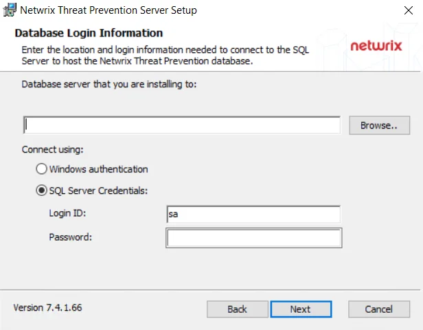

Step 7 – On the Database Login Information page, provide the SQL Server information for database connection.
In the first box, enter the IP address (may need instance port number, e.g. 192.168.189.152,1433) or the server name (Server\Instance) of the SQL server where the Threat Prevention database resides. Click Browse to select the server.
Select the Windows authentication or SQL Server Credentials option button (for SQL Server authentication) and enter the credentials:
- Windows authentication uses the credentials provided on the Logon page, which is displayed if this option is selected.
- For SQL Server authentication, provide SQL credentials in the Login ID and Password boxes.
noteThe account used for authentication, either a Windows or SQL account, requires a minimum of the following permissions on the SQL Server:
- Create schema
- Read
- Write
Click Next.
If using Windows authentication, continue with the next step.
If using SQL Server authentication, skip the next step.
noteIn case of SQL Server authentication, the credentials are tested on clicking Next. If the credential authentication fails, the setup does not proceed and a pop-up window displays failure details.
Step 8 – If Windows authentication is selected, the Logon page is displayed.
Provide the username (Domain\User format) and password that the Threat Prevention Enterprise Manager service will impersonate when connecting to the database. These credentials must have elevated privileges with rights to create and modify the database.
noteWindows authentication uses an Active Directory account. Local Windows accounts are not supported.
Click Next.
noteFor Windows authentication, the credentials are tested on clicking Next. If the credential authentication fails, the setup does not proceed and a pop-up window displays failure details.
