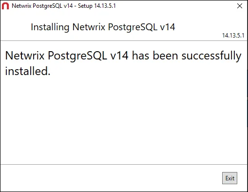

Step 5 – The installation begins and the installer displays a Setup Progress window. Click Exit when the installation is successful. The Netwrix PostgreSQL Setup wizard closes.
The PostgreSQL database application is now installed. Nest you can install the Netwrix Threat Manager Reporting Module application. See the Install the Netwrix Threat Manager Reporting Module topic for additional information.
