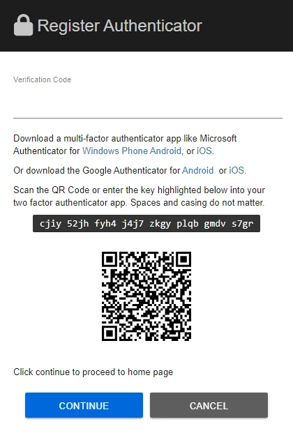

Step 1 – Register the MFA authenticator. The Register Authenticator prompt will provide instructions to configure multi-factor authentication with an external or third-party application.
Step 2 – On successful registration with an authenticator, enter the verification code and click Continue.
Step 3 – A list of recovery codes will be presented in order to restore access to the application in the event of lost access to the authenticator application or device. Save this list of codes to access for account recovery, if needed.
Step 4 – Click Continue.
