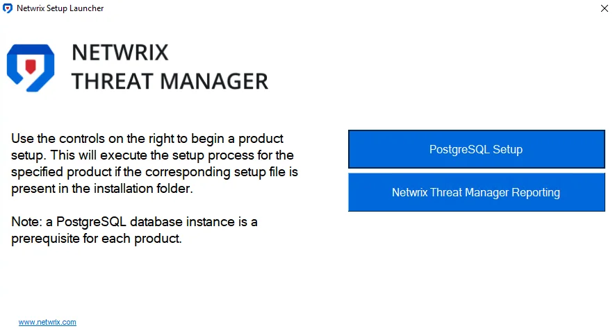

This executable starts a setup launcher containing buttons to install the PostgreSQL database and the application. The launcher installs these components on the same server. See the installation details for each components below.

Step 1 – Right-click on Netwrix_Setup.exe and select Run as administrator. The Netwrix Setup
launcher opens. You can now install the following components on the same server:
- Click PostgreSQL Setup to install the database. See the Install the PostgreSQL Database Application topic for additional information.
- Click Netwrix Threat Manager Reporting to install the application. See the Install the Netwrix Threat Manager Reporting Module topic for additional information.
