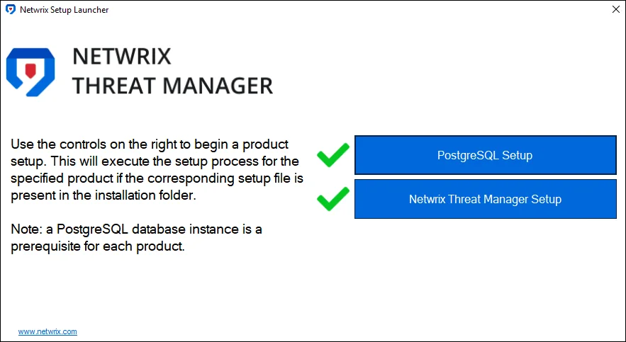

Step 1 – Run Netwrix_Setup.exe as an administrator. The Netwrix Setup Launcher window is displayed.
Netwrix Threat Manager Setup window

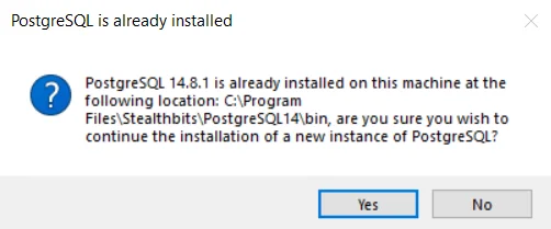

Step 2 – Click PostgreSQL Setup to upgrade the PostgreSQL version. The following message is displayed, indicating the currently installed version:
Threat Manager Reporting - Upgrade DB Confirmation dialog box
Step 3 – Click OK to upgrade. The Netwrix PostgreSQL Setup wizard opens.

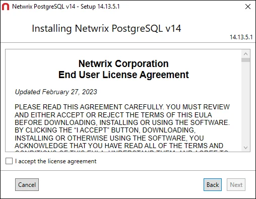

Netwrix PostgreSQL Setup wizard on the EULA page
Step 5 – Read the End User License Agreement and select the I accept the license agreement checkbox. Click Next.

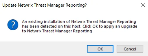

Step 2 – Click Netwrix Threat Manager Setup to upgrade to version 3.0 of the Netwrix Threat Manager Reporting Module. The following message is displayed:
Threat Manager Reporting - Upgrade Application Confirmation dialog box
Step 3 – Click OK to upgrade. The Netwrix Threat Manager Reporting Setup wizard opens.

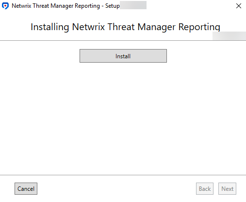

Netwrix Threat Mannager Reporting Setup wizard - Install page
Step 4 – To follow through the steps of the wizard for upgrade, see the Install the Netwrix Threat Manager Reporting Module topic, starting at Step 2.
