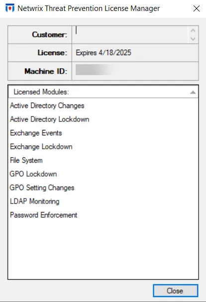

License Manager Window
The License Manager window displays the Threat Prevention modules that you are licensed for. If under an Enterprise license, it also displays an expiration date. On license expiry, the Enterprise Manager will refuse events from all Agents.
Remember, if events are not received and displayed in the Administration Console, check if your license has expired.

View Licensing Information
Follow the steps to view your Threat Prevention license details.
Click Help > License Manager on the menu. The Netwrix Threat Prevention License Manager window is displayed.
This window lists the modules that you are licensed for. Each module is linked to a Threat Prevention solution.
Following is a list of the solutions with their respective modules. You can also view the event types available with each module.
The Password Enforcement module is available under all licenses for monitoring weak passwords. However, you need the Enterprise Password Enforcer solution license to block weak passwords.
