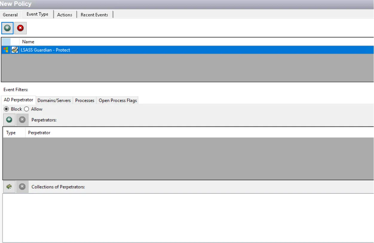

Based on policy rules, the LSASS Guardian – Protect event type can prevent processes not ‘white listed’ from accessing LSASS by preventing the Write, Read and/or Create Thread operations. An event is generated for each prevented access attempt with details about the process and as it’s attempted versus actual access allowed.
The event filters for the LSASS Guardian – Protect event type are:
- AD Perpetrator
- Domains/Servers
- Processes
- Open Process Flags
Each filter tab acts like an "AND" statement for the filter. Any filter tab left blank is treated like an "ALL" for that filter set.
CAUTION: Lockdown/blocking policies with blank filters result in everything being locked down or blocked.
RECOMMENDED: Add exclusion process filters for undesired processes that make changes to LSASS, e.g. third-party malware applications.
AD Perpetrator Filter
Use the AD Perpetrator filter for lockdown to set the scope of the policy to lockdown specific security principals committing changes or to exclude specific security principals committing changes from being locked down.
Select the Block or Allow option button and then edit the list.
NOTE: For the Password Enforcement Event Type, selecting Allow means that this policy will not validate the new passwords for the accounts listed here. Selecting Block means that this policy will validate the new passwords for the accounts listed here.
Use the buttons in the Perpetrators and Collections of Perpetrators areas to edit the lists.
- Perpetrators area – The Add (+) button opens the Select Active Directory Perpetrators Window.
- Collections of Perpetrators area - The Collection button opens the List of Collections Window to the appropriate Collection category.
- The Remove (x) button deletes the selected item(s) from that box.
NOTE: To enable a Dynamic Policy, use the Collection button to select the desired Dynamic Collection. See the Dynamic Collections topic for additional information.
