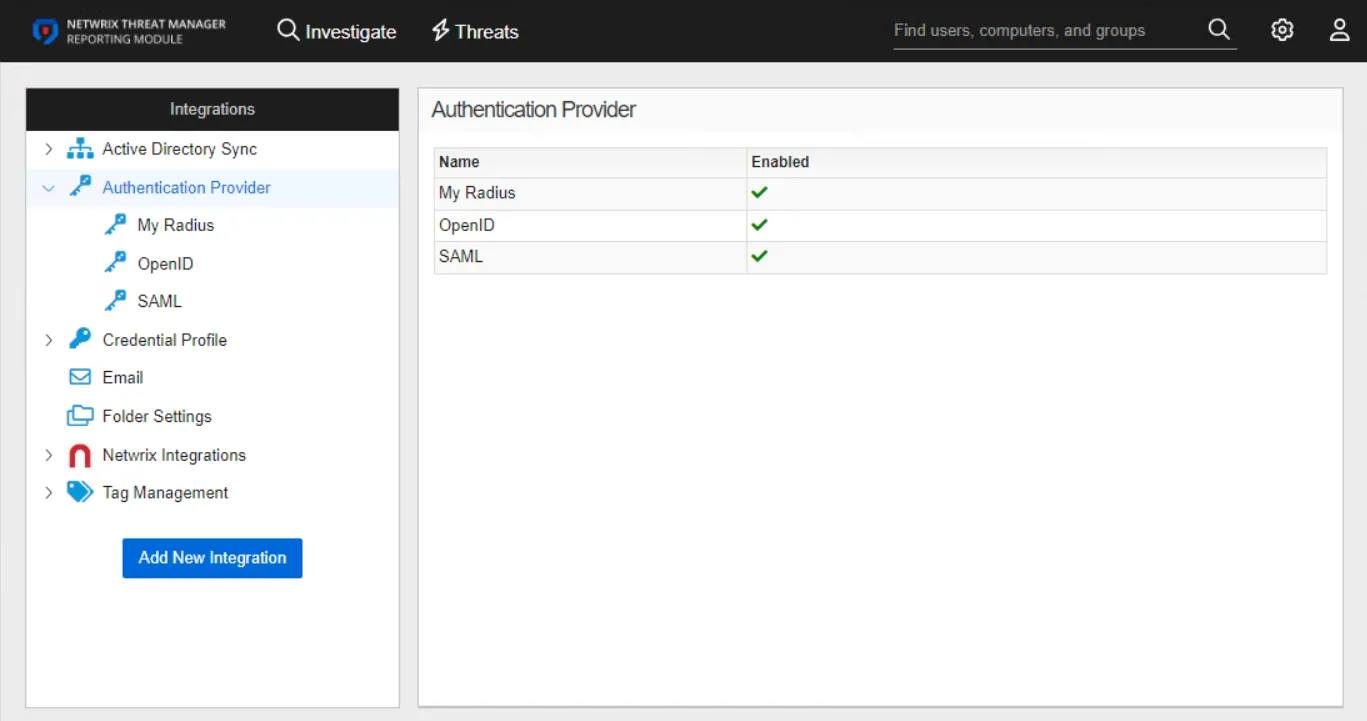

Click Authentication Provider in the navigation pane to view a list of already configured authentication providers, if any.
The table displays the provider name, as supplied during configuration, and an icon indicating if the integration is enabled. To view provider details or make modifications, select a provider from the table or select it from the Credential Profile drop-down in the navigation pane.
